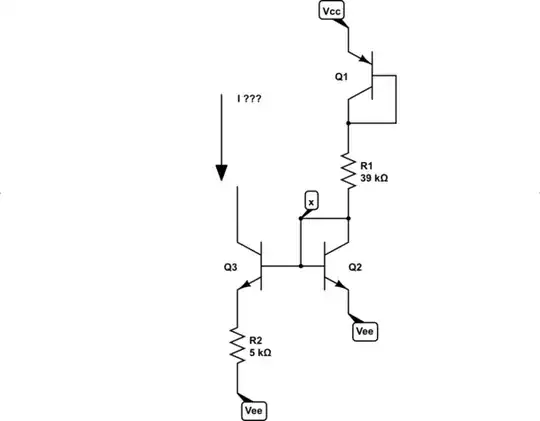

A more complex problem might be working out the following current mirror circuit that is found in an old opamp, the 741: found in this EESE schematic:

I'll use LTspice for simulation, which uses \$V_T=25.865\:\text{mV}\$ by default. Both of the included 2N2222 and 2N3906 BJTs have \$I_{_\text{SAT}}=10\:\text{fA}\$. Assume \$V_{_\text{EE}}=0\:\text{V}\$ and \$V_{_\text{CC}}=15\:\text{V}\$. A quick estimate for \$R_1\$'s current is \$\approx 350\:\mu\text{A}\$. (The diode-connected BJTs, \$Q_1\$ and \$Q_2\$, slightly dropping some of the applied voltage.) This means that \$V_x=V_T\cdot\ln\left(\frac{350\:\mu\text{A}}{10\:\text{fA}}\right)\approx 628\:\text{mV}\$.
Assuming collector and emitter currents the same, the unknown current is about:
$$I_{R_2}= I_{_\text{SAT}}\cdot\exp\left(\frac1{V_T}\cdot \left[\vphantom{\frac1{V_T}}V_x-R_2\cdot I_{R_2}\right]\right)$$

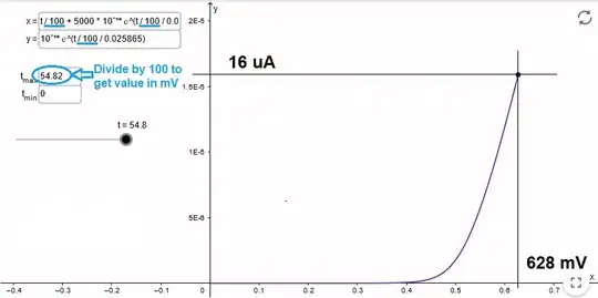

Set \$t=V_x-R_2\cdot I_{R_2}\$. Then:
$$\begin{align*} I_{R_2}&=I_{_\text{SAT}}\cdot\exp\left(\frac{t}{V_T}\right) \\\\ V_x&=t+R_2\cdot I_{R_2} \\\\ &=t+R_2\cdot I_{_\text{SAT}}\cdot\exp\left(\frac{t}{V_T}\right) \end{align*}$$
\$t\$ will be small, so I'll multiply it by 100 to magnify it in the plotting. Keep it in mind:
This shows that I will expect to see about \$16\:\mu\text{A}\$ for the unknown current and that the voltage across its base-emitter should be about \$548\:\text{mV}\$.

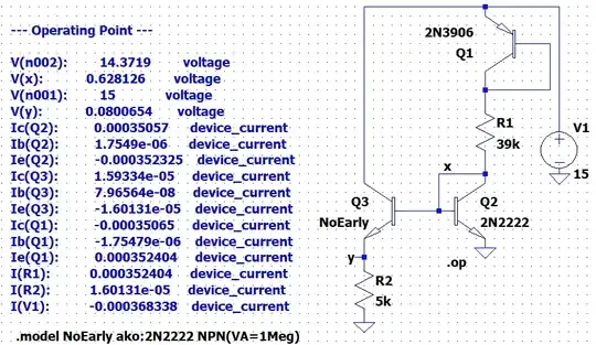

Let's run LTspice:
Looks the same to me. Just as predicted. For example, \$V_x-V_y=628\:\text{mV}-80\:\text{mV}=548\:\text{mV}\$. (Note that I removed the Early Effect from Q3, which isn't accounted for in the above analysis.)
