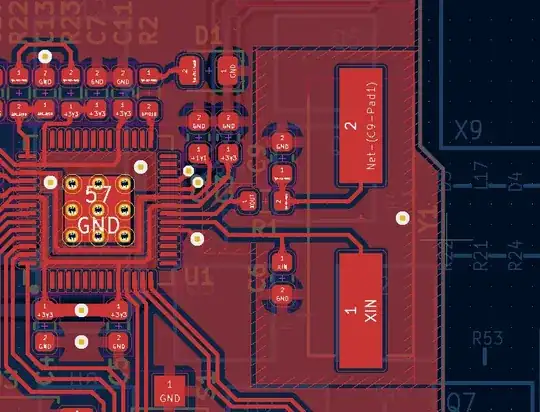

I've looked through this forum about PCB design of crystal oscillator and followed the tips, but I still not confident.
Any kind of feedback would be appreciated.
I put the 12 MHz crystal surrounded by a local GND plane and connected this plane to the the bottom uninterrupted GND plane through only one via.

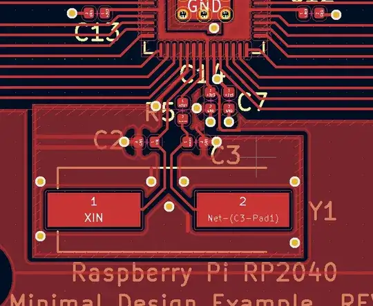

Adding manufacturer reference enter image description here

  • Which MCU is that? Have you looked at MCU provided documentation? The single via to GND plane and the long loop from capacitors to the via sounds against most suggestions - it may still work just fine, but why bother isolating an area if it does not go via a noiseless route to MCU ground pin dedicated for crystal connections. – Justme Apr 17 '23 at 13:44
  • RP2040. I tried to follow the design suggest on the minimal hardware reference, but got in doubt about the vias. – Gabriel Godoi Apr 17 '23 at 13:54
  • Those vias look explicit enough as to not create doubts so, what doubts did you have @GabrielGodoi and why did you have them? – Andy aka Apr 17 '23 at 15:40

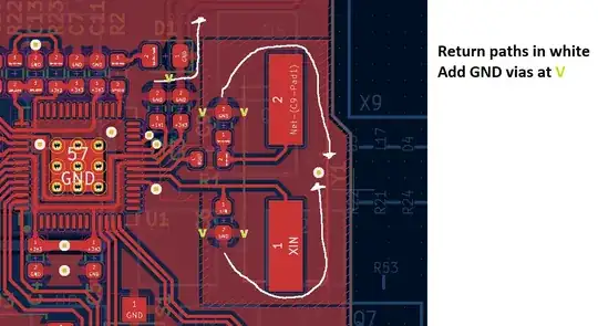

Splitting the GND plane is not a good idea, you should have one solid GND plane, on multiple layers. Consider what this split does to the current path from C9 and C6, it adds a pretty big loop that will result in inductance, degrading their performance, and potentially causing EMC issues. It also pinches the return path around C9 and D1, though I'd consider stitching these even if the plane was solid. Best practice is to have a Via on either side of a capacitor's pad. I cant pretend I do this 100% of the time, and it's not always practical, but I've drawn this for you here.
enter image description here If you get rid of the GND plane split I'd consider that a good layout, although I'd add a few more Vias to stitch the GND a bit better. It looks to me like the Xtal could move a smidge closer to U1, so you should do this unless you think it will give you assembly problems.
Also, as a very minor point, you could consider decreasing your thermal isolation, usually, I match this to my clearance, but this very much depends on how you're assembling these boards, and whether or not you feel this is needed to assemble the board well.

  • I added the manufacturer reference I followed, could you enlight me about how this apply to the manufacturer reference? – Gabriel Godoi Apr 17 '23 at 14:00

  • @GabrielGodoi, in that image, the GND plane isn't actually split, there's a GND plane around the Xtal, and the surrounding pour is actually 3v3. The GND is well stitched, presumably to a pour on another layer. It doesn't look like a great layout to me, particularly that seems like a bad way to route the 3v3, but that's a bit beyond the scope of this question. – LordTeddy Apr 17 '23 at 14:51
