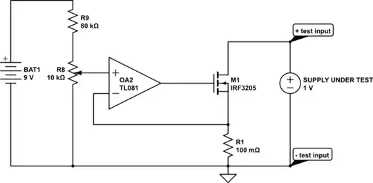

Back when I worked at MAXIM (Integrated Products) and we needed a few simple loads for testing (we had large, digital HP loads for all of our critical, detailed tests, but we needed a couple simple and cheap loads for more generic testing), the engineer gave me a schematic for a simple adjustable load using an op-amp and a MOSFET. The op-amp was of a very low quiescent power and a MOSFET in general needs almost no control current if used as a variable resistance. We used a 9V battery block as a supply for this circuit, which could last for months, if not longer.
Below is not the exact schematic, but what I remember of the basic circuit. Your dissipation power is limited by the maximum power dissipation of the MOSFET, plus the current sense resistor needs to dissipate significant power (it can also be changed according to your needs).
schematic

  • This is a most interesting circuit. – quantum231 Apr 15 '23 at 09:13
  • @quantum231 Yes, it's simple and elegant. Its current is defined by the voltage at the output of the potentiometer divided by the R1 (current sense) resistance, and is as stable or as accurate as the voltage supplied to the potentiometer and the resistance of the R1 sense resistor. – Edin Fifić Apr 15 '23 at 09:27
    This circuit needs more components in the feedback network, I remember soldering pretty much exactly the same circuit myself, but the sinked current would oscillate. You need dampen the control loop with some nF of capacitance, but I don't remember the details. – anrieff Apr 15 '23 at 09:40
  • @anrieff You're right, I have come across someone mentioning an RC combination (resistor and capacitor in series) going from the output to the inverting input of the op-amp, if I remember correctly. – Edin Fifić Apr 15 '23 at 09:45

    Control signal goes to + input of op-amp. Output of op-amp goes to gate of mosfet. Source of mosfet goes to sense resistor to ground. - input of op-amp goes to source of mosfet. Drain of mosfet goes to rail under test. Feedback in the op-amp works to maintain the desired voltae across the sense resistor and hence draw a defined current from the rail under test, – Peter Green Apr 15 '23 at 09:38

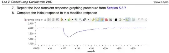

If you are testing a power supply which involves DC-DC conversion then the voltage regulation in response to transients in the load current might be important to test. This is a case where an active electronic load allows improved testing compared to a fixed or manually adjusted rheostat.
Reference Designs: TIDM-DC-DC-BUCK C2000™ Digital Power BoosterPack™ is an example board which contains:
  • A Non-Isolated, Digitally-Controlled DC-DC Buck Converter
  • An Onboard Active Load for Transient Performance Testing
In the above linked design guide their are examples of plotting the output voltage in response to a load transient from the active load under different control-loop conditions for the software controlled DC-DC buck regulator. E.g.: enter image description here
