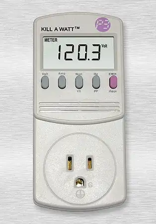

A less exciting solution is to buy a Kill-A-Watt for $18:
photo of kill-a-watt
