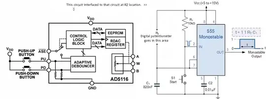

I need to be able to interface the left circuit to the right one in the image below. PWM Circuit Sections
Image adapted from AD5116 datasheet, figure 1 & Electronics Tutorials, 555 Timer Tutorials

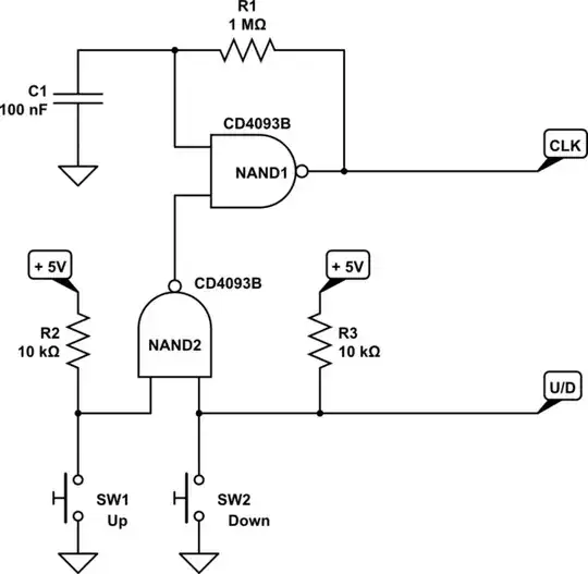

An AD5220 can do it with a little logic. Something like this:-
schematic
The CD4093B contains four NAND gates with Schmitt trigger inputs. In this circuit we only use two of them. The top NAND gate is configured as a clock generator running at ~10 Hz (frequency determined by C1 and R1), controlled by the lower input which must be high for oscillation.
The bottom NAND gate output goes high if either push-button is pressed. If the 'down' button is pressed it also pulls the AD5220 U/D pin low to count down (otherwise it counts up).
One limitation of this design is that the AD5220 always starts in the center on power up. Non-volatile digital pots with EEPROM memory are available, but all the ones I looked at used an I2C or SPI interface. If the pot needs to retain its setting when powered off it might be better to use a small MCU to generate the PWM signal directly, eliminating the need for the digital pot and 555 timer as well as several other components.

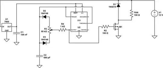

Something like this should work, where R3 represents the AD5116 80kΩ version.
It's necessary to regulate the 12V down to 5 because the digital pot cannot handle more than about a 5V supply. If your fan is 5V it is not necessary.
A CMOS version of the 555 would probably be better.
M1 should be a logic level MOSFET with switching characteristics specified for 4.5V Vgs and adequate rating for the fan.
With the given components, the PWM frequency is about 20kHz. Adjust C2 for higher or lower frequency.
