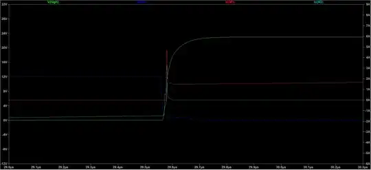

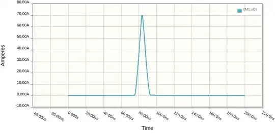

The problem occurs when the high side switches on. You can see in the image below that the current through M1 and M2 spikes up. Building the circuit works but only if V2 is under 7 V and a PC audio volume less than 40%. If I increase either variable, the current spikes, activating my power supply's overcurrent protection and sometimes burning the UCC27282 MOSFET driver (I've burnt over 20 MOSFET drivers already, each costing me 4 CAD).
Figure 2

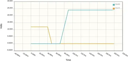

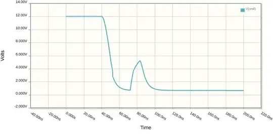

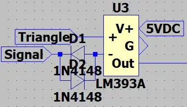

I initally thought I would need external dead-time, which I can add by adding two reverse parallel diodes on the inverting input of the comparator U3, thereby reducing Square-'s duty cycle:
Figure 3

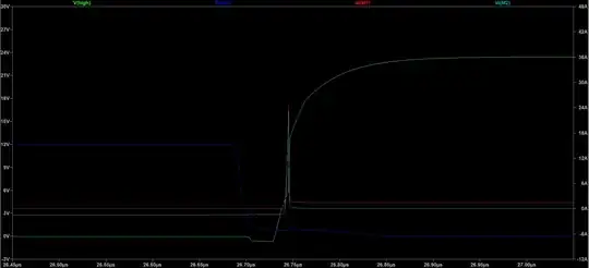

Now going into the simulation, the shoot-through current is even worst, going from about 5 A previously, to about 27 A.

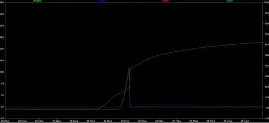

So, I undid the changes to the comparator U3 and decided I would test what would happen if I replaced the Square- signal on the MOSFET driver's LI with ground (I think doing this might affect the bootstrap circuit as the bootstrap capacitor is now charging through a higher impedance path via the load) and this is what I get.
Figure 5
WOW! 40 A of shoot-through current?! How is the low-side MOSFET turning on even though its gate voltage is zero? Or... is it? Upon further inspection there appears to be spike of 1 V of V_GS before completely going to zero. But the 1 V spike occurs when the shoot-through current drops and 1 V is less than the IRFZ44N's V_GS_threshold of 2 V. Is this actually not shoot-through current? Does the MOSFET enter the linear region? How am I in engineering?
If I replace the 10 kΩ resistors on the MOSFET's gate to source with 1 kΩ, there is a slight decrease in shoot-through current, it's almost negligible. I ended up reading about miller clamp circuits and thought that its low ON impedance would quickly discharge the MOSFET's gate-source capacitance as opposed to using a resistor. Still negligible effects.
I ended up trying a higher V_GS_threshold MOSFET (IRF530) instead, and the shoot-through current did decrease to about 1 A, but adding dead-time is still not completely getting rid of it.

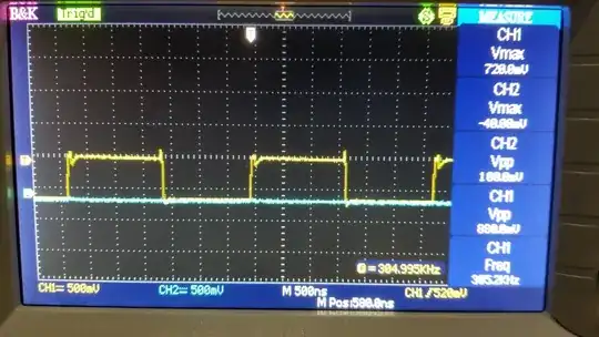

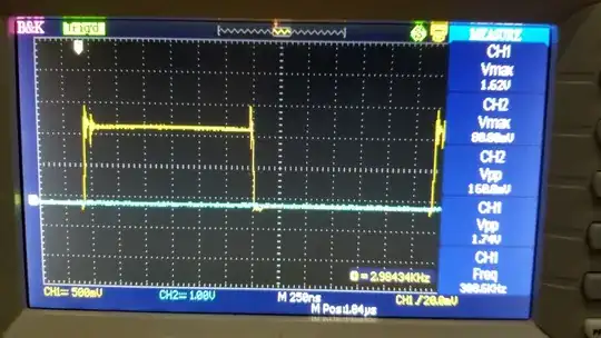

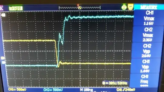

Here is the working circuit on a real scope. x10 attenuation is used to minimise probe capacitance. You can find the board layout link in one of the comments below (sorry, not enough reputation apparently).
In the image below, we have yellow as High (M1's V_G to GND), and blue as Low (M2's V_GS).
Figure 6

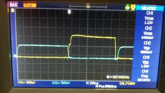

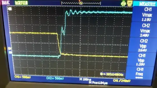

The yellow signal in the image below shows M1's V_DS, so my thinking here is that, M1 is ON when the V_DS is zero as that is the voltage drop across it.
Figure 7
Finally we have M2's V_DS as a yellow signal again. I can't have both V_DS show on the scope, since their reference points are not the same and I don't have differential probes. Yes, this is probably going to limit the information we have. Anyways, M2's V_DS looks weird since the wave is slanted a bit.

I've also tried out Simon Fitch's Miller clamping circuit on the actual circuit this time and here are the results. Blue is High (M1's V_G to GND), and yellow is Low (M2's V_GS).
Before enter image description here After enter image description here
You can see that the signal to M2 turns off a little faster and reduced the ringing on the High signal after it switches on. These results were taken after I replaced C7. I would also like to mention that before C7 replaced the ringing was much higher that it was outputing a constant high pitched noise on my speaker.

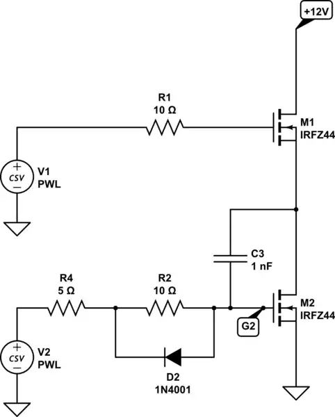

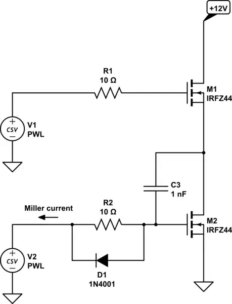

I think it's Miller capacitance giving you grief. I think that the single-diode implementation of the miller clamp, that you have used (see below) is not working as you expect:
schematic
V1 and V2 are ideal sources, producing the following potentials:
I've removed all capacitance from the transistor models, \$C_{ISS}\$, \$C_{OSS}\$ and \$C_{RSS}\$, and inserted a single capacitance C1 to mimic Miller capacitance. Obviously, this is an exaggerated scenario, but it's just to illustrate why the solution I propose at the end can work.

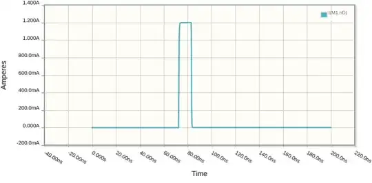

Without a clamp diode, Miller current causes a large voltage drop across R2, switching M2 back on momentarily. M1's drain current looks like this:
When we insert the diode, remembering that the source is ideal, Miller current is effectively bypassed, so only a volt or so appears across R2, and M2 stays off. Drain current stays low:
The diode does well, but its effectiveness depends on the source impedance of the driver. Since all that miller current is being fed right back into the driver's output, any impedance there will cause gate potential to rise, also. The diode is only bypassing R2, not the driver's own output impedance. Here I use R4 to mimic a source impedance of just a few ohm. Miller current through it will cause M2's gate potential to rise again:
schematic
simulate this circuit
Below is the resulting gate potential, where you can clearly see that it's enough to switch M2 back on momentarily. After that, the drain current spike returns:
I suggest you try to divert Miller current direct to ground, with a PNP bipolar transistor:
schematic
In this way only 1% or so of Miller current makes it back through R2 and the driver's output impedance, and the rise in gate potential is attenuated, hopefully enough to prevent M2 from switching on again. Drain current is suitably dampened to a reasonable amount:

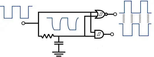

Either use a standard MOSFET driver that has shoot-through protection inside or, use this type of circuit: -
Image from here. Place the circuit prior to U4 and get rid of U3.

    UCC27282 (https://www.ti.com/lit/ds/snvsaq5b/snvsaq5b.pdf) has cross-conduction protection. Is it not the same as shoot-through protection? I've also tried the circuit you gave and although the input signals do appear cleaner, the shoot-through problem still exists. – Random Burnout Mar 19 '23 at 22:06
    Make the capacitor value bigger to get a bigger gap. What values did you use and what gates did you use? The devil will be in the detail @RandomBurnout – Andy aka Mar 19 '23 at 22:18
  • I've used several capacitance and resistor values of different orders magnitude to get different dead-time values. The shoot-through has always occured when the high-side MOSFET turns on regardless of how big or small the deadtime. For the logic gates, I used the a NOR and AND gate provided by LTspice with "Vhigh=5 Vlow=0 Ref=1.0" written in SpiceLine option. – Random Burnout Mar 19 '23 at 22:44
