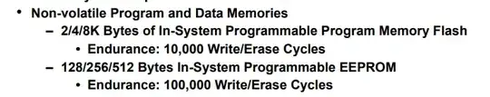

Sometimes it is just on the first page of the datasheet:
It reads on the first page of the data sheet.
EEPROM is specified for 100000 write/erase cycles.
It does not depend on how often you do it, no matter how fast or slow it still is 100000 write/erase cycles.

    Some caveats apply. The EEPROM page size is 4 bytes so if you write four bytes all four memory locations are erased and written four times. Unless you mean the program flash. That's only 10000. – Justme Mar 18 '23 at 16:58

    Then you mean the program memory flash. – Justme Mar 18 '23 at 17:08
  • Then even 10,000 cycles should be reasonable. I have mistakenly assumed the limit would be way more less (about 50-100 cycles) and so thought it would be risky to flash it too often during development before I finish my project. – Tintenfisch Mar 18 '23 at 17:11
