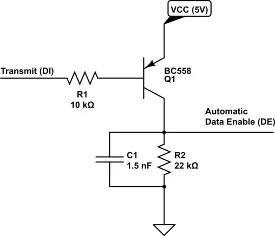

Well "good" is a vague term, but you did say "cheap"...
The simplest solution to this I've seen and tested myself is to use a PNP transistor and RC network. The following example is intended for 9600 baud, so a 22k resistor and 1n5 capacitor are used. These values would be modified for different baud rates.
This is by no means an elegant solution, but it's simple and can be build from the parts bin.
Here's the schematic:
schematic
