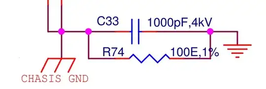

In our design we've used a parallel RC circuit for chassis ground and digital ground isolation
The resistor value is 100 Ω. The capacitor is 1000 pF 4 kV.
I was told that it's basically for "EMI, EMC and ESD protection".
Why exactly is it used? How does the the parallel circuit precisely work and help in preventing ESD and EMI/EMC noise?

The circuit is a standard solution to improve ESD discharge robustness of your board/device. A metal connector housing is the most likely area for an ESD discharge either directly by touching or indirectly via the connected shielded cable. By coupling the connector housing via an parallel RC circuit and not directly to PCB ground you limit the peek of ESD energy injected into your PCB during an ESD event so improving your PCB ESD robustness. And because of the capacitor you still have good hi frequency coupling of your connector housing and connected shielded cable to ground so your shielding still performs its function. Its similar in the usage in PCB ground connection to device chassis ground, to on one side provide coupling for EMC shielding and on the other hand to reduce ESD discharge energy to your PCB in an ESD event comparing to direct connection. Sometimes its also only used as capacitor only especially when you have an AC connected device where you don't want no DC coupling at all...
So in short for a simple explanation, but as always you can make more science out of it, end there can be some interesting EMC related usage as well :)
