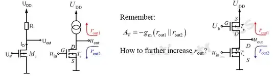

i.e. Why don't we make both the input and the load transistors as NMOS?
M.A.
If the load transistor were an NMOS, it would act as a common-drain amplifier and try to hold the output at a constant voltage. (\$V_{GS}\$ would be the difference between the NMOS gate voltage and the output voltage.) With a PMOS in the common-source configuration, a constant gate voltage gives you a constant \$V_{GS}\$. A MOSFET driven with a constant \$V_{GS}\$ acts roughly like a constant current source, which is a good load for an amplifier.

  • But won't an NMOS load have a constant Gate Voltage? Which can then be configured like the PMOS (Source would be connected to VDD providing constant Vgs), and both drains would be connecting to each other. – M.A. Mar 03 '23 at 16:27
    @M.A. If you use an NMOS, the terminal at the VDD rail isn't going to be the source. It's going to be the drain. If you use a discrete nFET, you'll have to place it in that orientation to avoid shorting it through the body diode. If you use an integrated nFET, your source/drain is controlled by the relative voltages, not the fabrication because it's a symmetric device. You may benefit from reading this answer that I wrote on a very similar question in the past. – nanofarad Mar 03 '23 at 16:34
