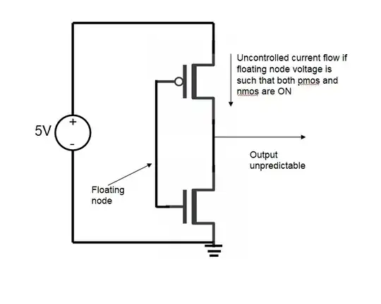

With this simple case that I drew below, you can see that a floating node can cause
a) unpredictable output. Gate leakages generally determine the voltage of the floating node in this case and we can never say what voltage the floating node will settle to. If there is a routing running close to this floating node, the capacitive coupling between the 2 lines can also disturb the voltage on this line as it is very high impedance.
b) unexpected current consumption. Normally the gate of this inverter is 0 or 5V. So, either NMOS is OFF or PMOS is OFF. However, if the node settles to say 2.5V, both PMOS and NMOS are strongly ON and can cause huge leakage from the 5V supply to ground depending on the drive strength of this inverter.

  • What are gate leakages? Why is the line high impedance? Is it because current can't easily flow along the line? Is the lack of current flow what causes its voltage to be so strongly affected? – Connor Mar 01 '23 at 13:18
  • How bad could the leakage be in this situation? Melting the circuit board bad? – Connor Mar 01 '23 at 13:19

    @Connor, a net is very high impedance if there is no path from that net to any other low impedance net like supply or ground. Since the impedance on that net is purely capacitive, at DC, the impedance of that net is theoretically infinite. So, even small leakage currents flowing into these nets can change the voltage significantly. Gate leakage of a transistor is the current flowing into the gate from other terminals of the MOSFET (Source, drain, bulk). – sai Mar 01 '23 at 13:47
    @Connor, Regarding the uncontrolled current, the magnitude is very much dependent on the size of the MOSFETs. If the MOSFETs are small, it may not cause any board issue. So, you'll really need to simulate the case or test it in the lab to find out. – sai Mar 01 '23 at 13:48

So what can happen in your circuit does not itself depend on how the floating node can affect the logic state, it really depends on what your circuit does with the logic state it receives, as the state may not be what is expected.
A floating node can be randomly stuck to either logic 1 or logic 0 and can also change randomly due to any effects such as leakage currents or nearby RF transmitters.
If the floating node connects to two inputs, one might interpret it as logic 0 and the other as logic 1 if they have slightly different thresholds deciding between 0 and 1.
On analog level, a voltage at the input threshold for an CMOS input will turn both the NMOS and PMOS transistors halfway on, so extra shoot through current can constantly pass from supply to ground.
