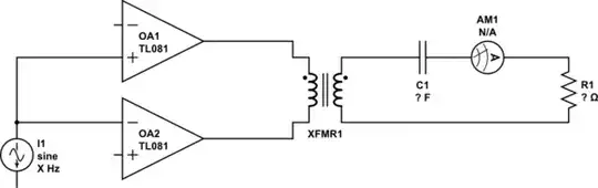

This is about what I know about the system:
schematic

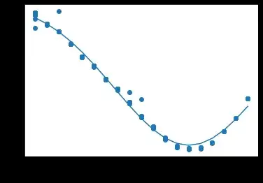

I figured out that on each frequency the voltage and current have the same ratio, so I decided to plot the "measured resistance" against frequency:
Frequency against resitstance
(Frequency on x, Resistance on y)
As you see I tried to fit a curve on it. This curve is just an inverted Gaussian curve, which I don't expect to be the right formula. I need to be able to calculate the expected restistance on each frequency (not just the ones I measured, but also in between each frequency measurement.)
Which formula could I use to fit the curve?

  • At any given frequency, you have a measured voltage and current. What do you mean by the "same ratio". Your curve clearly shows that the calculated resistance varies with frequency so it is not constant. Did you measure the phase difference between the voltage and current? From your circuit, this information will be needed since it is not a pure resistance given the transformer and capacitor. – Barry Feb 27 '23 at 13:27
  • @BarryI meant that when the Frequency is constant, then the ratio of V/I is constant. I have two parameters to play with, voltage and frequency, and no explanation if voltage is peak voltage, or the voltage over the amplifier. I never measured the voltage, I just set it. I only measured the peak current. – Typhaon Feb 27 '23 at 13:37
This is a standard RLC series resonance with a 2nd order equation with peaking in the transfer function defined by Q with reactance/load impedance ratios and resonance by reactance product values.
The theory was best outlined here.
Finding resonant frequency and cut-off frequency from Bode plot to calculate values for RLC circuit
Since the transformer blocks DC, this implies your output capacitor is redundant and perhaps a problem. If you remove that you will find the low frequency step response to 64% of the target to be T = L/R
This is basically saying that the system is a linear system. Twice the voltage means twice the current.
Also: luckily it is linear, because else your problem would have been drastically more difficult.
Fitting, or modeling an impedance in general requires some fairly advanced techniques. Usually, we discuss these things in the Fourier domain (frequency domain). For linear time-invariant systems, you should be able to model it with this equation:
$$\left|Z(j\omega)\right| = \left|\frac{V(j\omega)}{I(j\omega)}\right| = \left|\frac{B(j\omega)}{A(j\omega)}\right| = \left|\frac{\sum_{i=0}^{n_b} b_i\cdot (j\omega)^i}{\sum_{i=0}^{n_a} a_i\cdot (j\omega)^i}\right|$$
While \$a_i\$ and \$b_i\$ are real numbers, these quantities live in the complex plain, representing not only amplitude but also phase. You are trying to solve the problem using only the amplitude which might make it a little bit more tricky.
There are general-purpose algorithms to try and model such curves without knowing the model complexity (\$n_b\$, \$n_a\$) or any of their coefficients (\$a_i\$, \$b_i\$). In your case however, we might try modeling a single resonance peak and see if it matches. It just so happens that we know such resonance can be modeled by a transfer function of order 2.
So you might try to fit this second-order transfer function, normalizing such that \$a_0 = 1\$:
$$\left|Z(j\omega)\right| = \left|\frac{b_0 + b_1\cdot j\omega}{1 + a_1\cdot j\omega - a_2\cdot \omega^2}\right|$$
Or, by squaring the complex amplitudes:
$$\left|Z(j\omega)\right|^2 = \frac{b_0^2 + b_1^2\cdot \omega^2}{(1 - a_2\cdot \omega^2)^2 + a_1^2\cdot \omega^2}$$
I expect \$b_0\$ to be fairly small, because the lowest-frequency amplitude is also very small (if \$\omega = 0\$, then \$|Z(j\omega)|\$ should be small).
