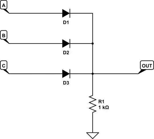

You have correctly identified that a NOT gate (inverter) is unable to provide a high output using power from a low input (since there's no input power), but it is possible for an AND or OR gate to do so, since a high output can only occur when one or more inputs are also high.
Here's an example of an OR gate which produces a high output using only the inputs as a source of power:
schematic
If the potential at any input (A, B or C) rises (a "high" input signal), then its corresponding diode begins to conduct, "raising" the output voltage to almost the same level.

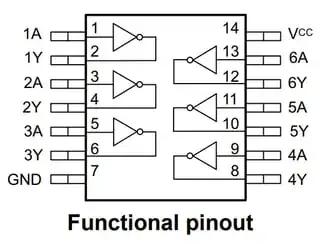

Modern systems are more sophisticated, and they derive their outputs from a separate power supply, as you noted. This is a picture of the connection pins for an IC that contains 6 inverters, the 74HC04 (which I borrowed from TI's datasheet, page 1):
The two pins 7 (GND) and 14 (Vcc) are where we connect an external power supply. They are a source of low and high potentials (representing logic 0 and 1 respectively) that the IC routes internally to those six outputs, depending on what it "measures" at the corresponding inputs.

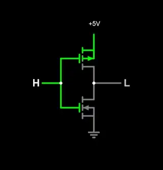

I think what’s confusing you is the notion that a logic ‘0’ represented as a zero-volts value is somehow ‘no signal’. It most definitely is: it’s a voltage that’s being held at 0V by something, referred to system GND. Sender and receiver agree on this shared understanding of '1' and '0' being referenced to GND.
A CMOS logic low is in fact a low-impedance connection to GND, not an open circuit. CMOS logic signals are explicity driven high or low by FETs.
You can think of a CMOS output as a single-pole double-throw switch that ties the output either to GND or the power supply. The NOT gate is the simplest of these, with just the FET pair, doing its SPDT thing.
Here's a CMOS NOT gate you can try for yourself (simulate it here)
You can see the action of the FET pair, connecting the output to either +5V or GND depending on the input. To function, it needs both a power/GND connection, and an input signal that is referred to GND to guarantee correct voltage to the FET gates.
Other logic families are similar: the driver always guarantees a valid voltage level representing either a one or zero, referenced to GND. Their inputs are never left 'disconnected'.
NOTE: In some logic families, a disconnected input will assume a logic level. TTL for example will assume a '1' due to its diode-OR type input structure with a local pull-up. This is not recommended practice. You can explore this further in Falstad, which has examples of TTL, DTL, RTL and other gates (see Circuits/Logic Families.)
