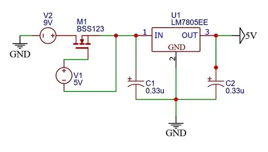

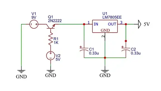

I am looking to make a very accurate steady 5V power supply that can be switched on and off using the digital IO pins on an Arduino. I planned to use a 9V power supply connected to a 2N2222 transistor switched on/off using the Arduino and the emitter pin of the 2N2222 connected to an LM7085 to get a regulated 5V (see image). Simulations say I won't get 5V out but I am not sure why.
Any help would be much appreciated.
The NPN BJT is acting as an emitter follower and this means that the emitter voltage must be lower than the base voltage. Given that the base voltage is 5 volts, I estimate that the emitter voltage will be about 4.3 volts and no linear regulator in the universe is going to conjure up 5 volts on its output from 4.3 volts on its input.

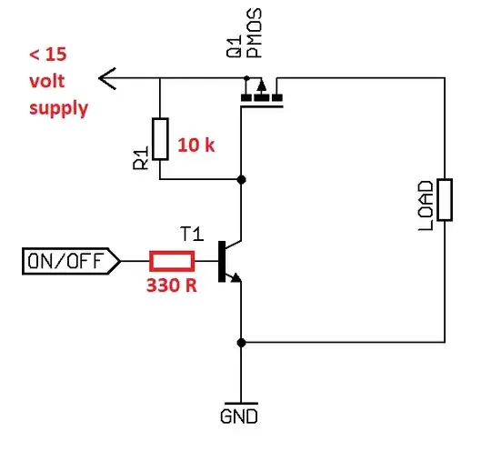

I recommend you use a PNP BJT to do the switching and use an NPN to control the PNP. Better still, use a p-channel MOSFET for the switching device. Something like this: -
Modified image from here.
