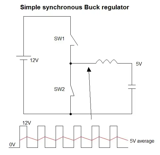

You can make a synchronous buck regulator that does a pretty good job of producing a fairly stable output. A sync-buck is just a power square wave feeding an LC low-pass filter so, if you know the input voltage and, have pretty decent MOSFETs to create the power square wave, you can adjust MOSFET duty cycle to keep the output voltage constant based on feed-forward techniques (not closed-loop): -
Image from this answer.
For e.g. for some step change in load current the buck converter would create the transients and settle down at some value other than nominal output value while the closed loop design reclaims the original nominal value for output voltage. Is this statement correct?
So, if you use decent MOSFETs even fairly heavy load changes won't disrupt the output accuracy too much. Of course, the icing on this particular cake might be to use some negative feedback as well but, it's not always 100% necessary.
Unlike non-synchronous buck regulators (whose voltage transfer ratio changes at low load currents), the sync-buck always keeps in an equivalent of continuous conduction mode and thus, it stays in regulation from zero load current to maximum load current.
