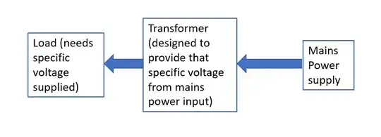

  • What is your actual problem you are trying to solve? Draw a schematic and/or block diagram. – winny Feb 13 '23 at 11:25

  • Thanks. Your block diagram shows what everyone expected, you need constant voltage to feed your load. Get yourself an SMPS made for the voltage and current you need. – winny Feb 13 '23 at 11:42

    BTW, an unrelated note: when you draw block diagrams is customary to draw them with the power/information flow going from left to right. That is power supply to the left, load to the right. This is just a basic convention in EE world. – LorenzoDonati4Ukraine-OnStrike Feb 13 '23 at 12:15
    Please put that into the question body. 4 kV won't come cheap even with a mains transformer, but granted, cheaper than SMPS. – winny Feb 13 '23 at 12:15
