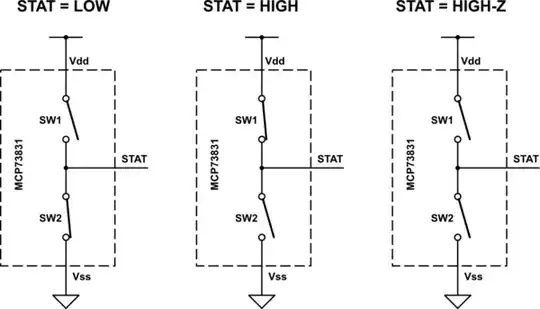

A tri-state output pin is just like a normal digital output (high or low), but which the IC can also effectively disconnect from everything. This is achieved inside the IC using transistors, but you can picture it as follows:
schematic
In the high-Z state (which means high impedance), the pin is essentially unconnected (inside the MCP73831, at least), so it won't source or sink any current.
As the datasheet suggests in section 5.2.1 (page 15), this behaviour can be used to power two different LEDs, or a single multi-colour LED, as a status indicator, but since you asked how to distinguish the high-Z state from the other two, I'll illustrate with an example.

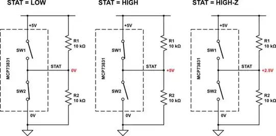

If you want to interface this output to, say, an Arduino, one way could be to use one of the ADC channels to measure the voltage on STAT. Use a resistor potential divider to gently coerce the potential of STAT to half way between the supply potentials, whenever the MCP73831 isn't explicitly imposing an output there (ie. during high-Z):
schematic
simulate this circuit
Of course, be careful if Vdd is above the maximum permissible ADC input voltage! The STAT signal might need some additional tweaking, but I think you can see how the thing works now.

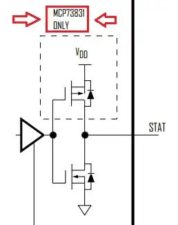

The MCP73831/2 is internally configured like this as shown on page 2: -
So, specifically for the 73831, if the upper (p-channel) MOSFET is activated, the STAT output will be unambiguously high (when not in shutdown mode). For the other version (the 73832) the upper MOSFET is not present and therefore it can only be high-impedance (requiring an external pull-up resistor) or, a low logic level. The 73831 is a push-pull output and only goes into tristate (high impedance) when in shutdown mode.
If you were using the 73832 you would use a pull-up resistor to determine the status but, you are using the 73831 hence, it will be either high, or low and not tristate (high impedance) except when in shutdown mode.

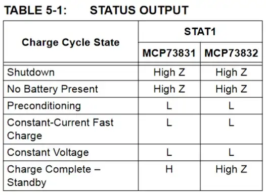

This charge complete mode would also mean the same when there is no battery connected to Vbat right? So, when charging is complete or the battery is disconnected, then the STAT pins would show the same result, right?
With the MCP73832 those conditions would be indistinguishable, but with your MCP73831, it will change between High and Hi-Z as shown in Table 5-1.
So you do indeed want to distinguish between High and Hi-Z. I recommend @notloc's answer to you, as it doesn't require any additional circuitry.
