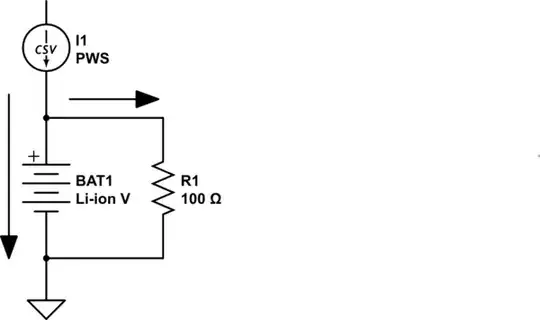

It really depends on the circuits involved. Li-ion batteries have a constant current followed by constant voltage charge profile. One issue is with the constant current part of the profile. During this time, the voltage can/will fluctuate depending on the batteries internal structure. Also the "load" is in parallel with the battery, so if the circuit pulls 0.5A and the battery charger is trying to push 1A into the battery, it's now down by 50% which will cause the charger to lower it's voltage which will affect the current into the battery etc.
If you look at the schematic below, as the battery voltage rises during charging, the charger is going to raise its voltage in order to maintain the constant current, and so R1 voltage will increase as a result. How this affects your circuit depends on the actual parts in use. Can they handle the voltage fluctuations, can the current source maintain stability with the extra current being siphoned off, will the battery reach a full(enough) charge?
