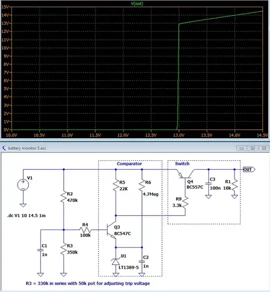

Here's a mostly discrete solution using a voltage reference and transistor as a comparator. It should draw very little current (under 100 uA) until it hits the turn on voltage. The sharpness of the turn on will depend on the load, if you need it to drive more than say 10 mA you might need to buffer it.
One downside is the cost of the voltage reference, the one shown can be around $10 USD. A zener can be used but it would need more bias current so the drain while off would be more, and the switchover isn't as sharp. Also high beta transistors should work best.
The circuit is simple, a voltage divider is fed into a transistor with a reference in the emitter path, creating a simple comparator which ten drives a series pass switch. The capacitors are to help with noise immunity.

  • @circuitfantasist can you suggest a way that I could use a comparator such as a LM393 to accomplish what I am looking to do? i cant get my head around it as it makes sense if you are referencing a lower voltage but not a higher voltage – robbrown92 Jan 20 '23 at 22:22
    @robbrown92, Just "improve" the GodJihyo's transistor circuit by replacing the transistor Q3 with the comparator. Use its non-inverting input instead the base, the inverting input instead of the emitter and the output instead of the collector. Everything is the same but more precise. The idea is the following: since the device is powered by the same voltage that is subject to comparison, you must proportionally reduce the measured voltage and compare it with a reduced but constant reference voltage... – Circuit fantasist Jan 20 '23 at 22:45
    Another approach would be to supply the device with a higher voltage (24 V) by a DC-DC converter and compare a constant part of it (13 V) with the measured battery voltage. – Circuit fantasist Jan 20 '23 at 22:46
    ill look into the transistor circuit, a higher ref voltage is not available. – robbrown92 Jan 21 '23 at 10:20
