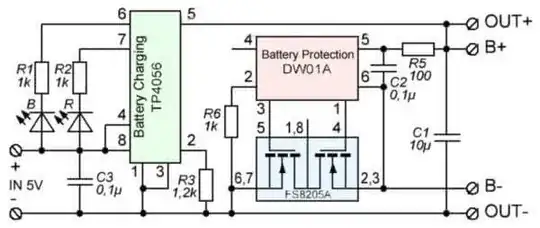

TP4056 module schematic: TP4056 module schematic

I expect the problem you are having is in wiring the charger modules together in series. The cells in series would add voltage and share current, but you're effectively inserting the FS8205A FETs and DW01A protection IC between every battery. There's actually a great question and answer about this very circuit you should check out.
Charger module schematic with current paths shown
Source
Huisman's answer shows that during discharge, the current path is as shown by the red line. The battery protection circuit is monitoring the voltage drop across the dual FET, which is likely calibrated for a single cell. When you connect additional ones in series, this voltage/current is not in the expected range, and the protection circuit switches the FETs off.
By connecting six cells in series (I'll use 3.7 V 400 mAh as the specifications for the 13400 cells) you would be creating a 22.2 volt battery, which should be OK as far as your motor is concerned. The problem is that the cells aren't strictly in series, because of the intervening protection circuits.
I'm not that familiar with these modules that you are using, but my expectation is that they are designed to work with a single cell and not be wired in series with others. You could disconnect the cells from the charging circuits and connect them strictly in series to power the motor, then remove them from the circuit entirely and charge them individually.
