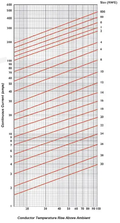

  • The temperature rise above ambient, for 50 A through 12 gauge wire in free air, would be about 100 degrees. Comparatively, for 6 gauge wire, it is negligible.
    Temperature rise chart of wire in free air
