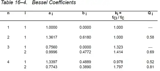

The Bessel filter can be broken down into two stages using coefficient tables. The tables have been produced and reproduced in many sources such as this one: -
I don't know the original source because it came from this question that I answered.
So, for a 4th order Bessel you get two lots of coefficients and these relate to two 2nd order stages having TFs like this: -
$$A_i(s)=\frac{A_0}{1+a_is+b_is^2}$$
If you multiplied both TFs together I'm sure you'd get something similar to what your equation is.
