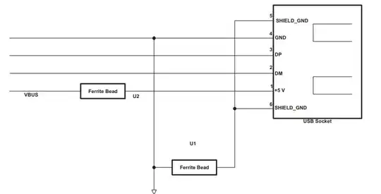

The below is take from TI application note(USB 2.0 Board Design and Layout Guidelines).
This is also a very good reference.(How to correctly connect a USB shield on a PCB)
Place a ferrite in series with the cable shield pins near the USB connector socket to keep EMI from getting onto the cable shield. The ferrite bead between the cable shield and ground may be valued between 10 Ω and 50 Ω at 100 MHz; it should be resistive to approximately 1 GHz. To keep EMI from getting onto the cable bus power wire (a very large antenna) a ferrite may be placed in series with cable bus power, VBUS, near the USB connector pin 1. The ferrite bead between connector pin 1 and bus power may be valued between 47 Ω and approximately 1000 Ω at 100 MHz. It should continue being resistive out to approximately 1 GHz, as shown in Figure above.

  • The ferrite on VBUS is serving as a low-pass filter for high frequency EMI on that line. Is it roughly equivalent in purpose and function to the LC low-pass filter in the schematic under the words "Example 1" on this page? https://www.acmesystems.it/pcb_usb Any advantage to the ferrite over the LC low pass filter (or vice versa)? – jemalloc Dec 25 '22 at 07:39
  • IMO it's not worth to consider individual conductors in a cable (e.g. shield) and prevent common-mode noise from them. It is common-mode. Decoupling one conductor with a bead is futile as the wires in the cable are all capacitively coupled. So this bead is bypassed by the other conductors. A common-mode bead on the cable is what inhibits cable noise. – tobalt Dec 25 '22 at 10:21
  • @jemalloc,Compared with general inductors, ferrite beads have a high resistance component R and a low Q value. These characteristics can be utilized in noise elimination – Hari Dec 25 '22 at 11:08
    Unfortunately, TI misreads the USB standard, and doesn't understand EMI. Any impedance between circuit (signal) ground and shield, explicitly permits external interference to enter, and unbalanced signals (namely J/K states) to radiate. This arrangement makes things strictly worse when there is no metal chassis to provide the necessary shielding. – Tim Williams Dec 25 '22 at 12:13
  • This approach may be acceptable when internal noise is low enough amplitude not to violate CMR, and when there is enough noise that isolating circuit ground from chassis ground is otherwise desirable (to reduce the noise current I suppose). Desktop PCs may be such an example. – Tim Williams Dec 25 '22 at 12:14
