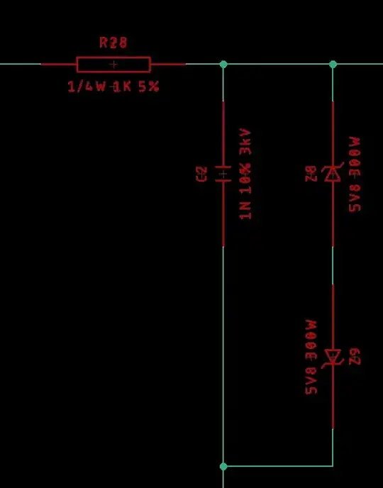

I am reading your questions somewhat like "Can I use a bidirectional 12V TVS across a solenoid coil as free-running diode?".
In this case: The point of a free running diode is to clamp the negative swing on the voltage across a coil to as close as possible too -0V. So by introducing the -12V bidirectional behavior you can harm your circuit.
In other cases like limiting the amplitude of a +/- analog signal they are just the easiest way to go. Feed the signal through a current limiting resistor and "clamp" it with the diode relative to GND on the full +/- amplitude band. If your resistance is big enough there will be no issues with power dissipation.
CAUTION: Using this circuit will introduce a RC-lowpass as TVS diodes (besides special types) can have significant capacitance!
This is the circuit I commonly use to limit external +/-5V analog signals and also provide ESD-protection. Even when used with two unipolar diodes and an extra cap I get f-3dBs at around ~130kHz which is good enough for my usual 100kHz uppper band-limit requirements.
