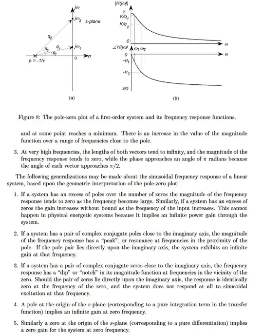

  • Poles tend to define attenuation in frequency rolloff as the denominator(s) for frequency s increase.
  • Zeros on top define gain which can be a high pass filter or bandpass on the rising side.
For more detail Read the 13 pages from MIT on Zeros/Poles
https://web.mit.edu/2.14/www/Handouts/PoleZero.pdf

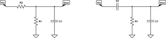

Let's look at two 1st order systems:
schematic
Then the KCL for these are (left column for the above left-side schematic and right column for the above right-side schematic):
$$ \begin{array}{c|c} \begin{array}{rl} \frac{v_{_\text{OUT}}}{R_1}+\frac{v_{_\text{OUT}}}{R_2}+C_1\frac{\text{d}}{\text{d}t}v_{_\text{OUT}}&=\frac{v_{_\text{IN}}}{R_2} \\\\ \frac{\text{d}}{\text{d}t}v_{_\text{OUT}}+\frac1{\left(R_1\vert\vert R_2\right)C_1}v_{_\text{OUT}}&=\frac1{R_2\,C_1}v_{_\text{IN}} \\\\ \left[D+\frac1{\left(R_1\vert\vert R_2\right)C_1}\right]v_{_\text{OUT}}&=\frac1{R_2\,C_1}v_{_\text{IN}} \end{array} & \begin{array}{rl} \frac{v_{_\text{OUT}}}{R_1}+C_1\frac{\text{d}}{\text{d}t}v_{_\text{OUT}}+C_2\frac{\text{d}}{\text{d}t}v_{_\text{OUT}}&=C_2\frac{\text{d}}{\text{d}t}v_{_\text{IN}} \\\\ \frac{\text{d}}{\text{d}t}v_{_\text{OUT}}+\frac1{R_1\left(C_1+ C_2\right)}v_{_\text{OUT}}&=\frac{C_2}{C_1+C_2}\frac{\text{d}}{\text{d}t}v_{_\text{IN}} \\\\ \left[D+\frac1{R_1\left(C_1+ C_2\right)}\right]v_{_\text{OUT}}&=\frac{C_2}{C_1+C_2}\:D\:v_{_\text{IN}} \end{array} \end{array} $$

To see that obvious fact, let's return to the earlier equations:
$$ \begin{array}{c|c} \begin{array}{rl} \left[D+\frac1{\left(R_1\vert\vert R_2\right)C_1}\right]v_{_\text{OUT}}&=\frac1{R_2\,C_1}v_{_\text{IN}} \end{array} & \begin{array}{rl} \left[D+\frac1{R_1\left(C_1+ C_2\right)}\right]v_{_\text{OUT}}&=\frac{C_2}{C_1+C_2}\:D\:v_{_\text{IN}} \end{array} \end{array} $$
