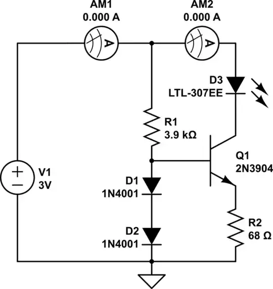

I have been thinking about how to produce an optocoupled input that works well over a wide voltage range, say 3V to 30V and I came up with the following schematic.
According to the simulator in CircuitLab it seems to work pretty well, maintaining an LED current between 5 and 10 mA and a total current of less than 20mA despite a tenfold change in input voltage.
schematic
(The ammeters shown are just to measure current. The LED represents the input LED of the optocoupler.)
Is this circuit a good idea, or is there some major problem I'm missing?

  • Good enough?...How can we tell without a spec. It is far better than a simple current-limiting series resistor. At 30V, a 2N3904 will get hot - near its thermal limit. – glen_geek Dec 09 '22 at 02:39
  • Peter, there's a lot of design detail here. It shows you how to read datasheets and design something that is also stable over temperature. Best wishes! – jonk Dec 09 '22 at 03:15
  • What about using an LM334? It only requires this IC and one resistor. – Bart Dec 09 '22 at 09:30
