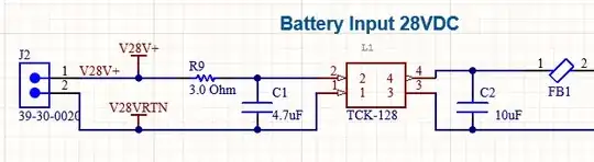

I am experiencing weird behavior with a common mode choke and had a few questions. The circuit in question is this: enter image description here
I am using a desktop power supply at 28V and 200mA current. This is the first time I've powered this board. Immediately, the voltage dropped to 0.64, the current went to 200mA and the power supply indicated an overload.

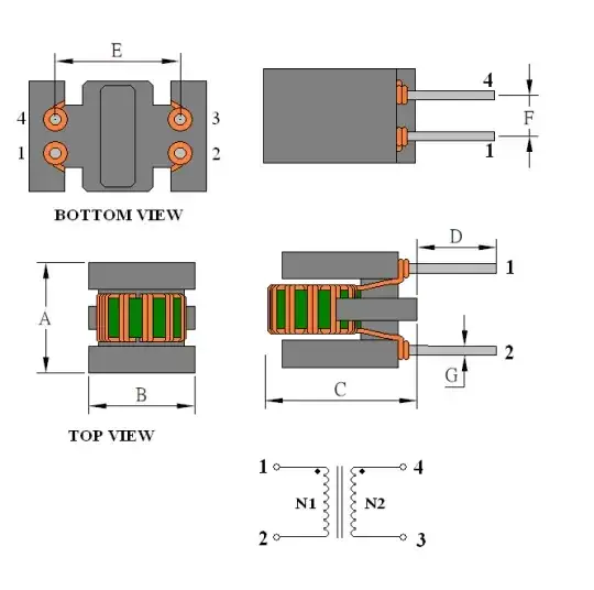

As far as I can tell there is no pin indication on the choke. However, looking at the data sheet pin 1 can only be 1 of 2 pins.
As follow up questions, I just noticed the dot notation and reading about this seems to indicate that positive polarity should go on the dot.
If that is true, my above schematic may be wrong since 1 is battery ground and 2 is battery positive, where as 4 should be positive and 3 should be ground. This this a concern?

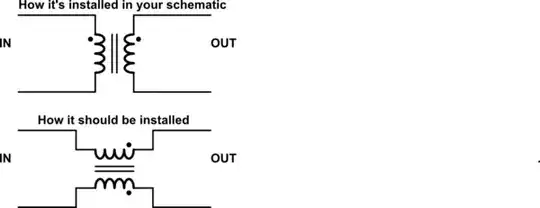

The choke needs to be rotated 90°. You are shorting out the power supply in the configuration in you're post. Using the proper symbol for the choke (essentially, a transformer) would make this obvious

There is no PCB layout how the pins of your PCB are really connected.
But if the PCB layout matches the pin numbers, the inputs and outputs are connected to wrong pins.
Giving power input to pins 1 and 2 means the choke shorts the power supply and that is not how the part should be connected.
Pins 1 and 4 should be on one side, for example power supply input, and pins 2 and 3 should be on the other side, output to device.
