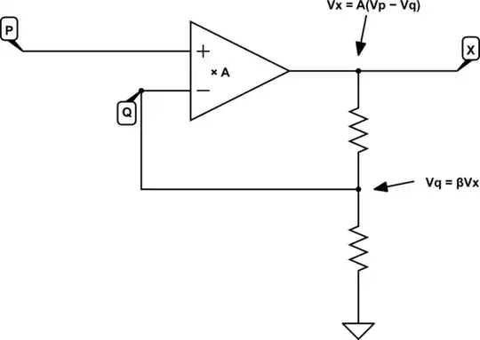

For an ideal op-amp, without feedback, your concerns are valid. Any non-zero difference between inverting and non-inverting input potentials results in an infinite output. The resulting gain equation for an open-loop ideal op-amp is algebraically dubious.
Even when we employ negative feedback, the resulting algebra contains an infinity in a numerator somewhere:
schematic
Bear with me here. The inverting input is presented with some fraction β of the output potential at X, giving us these equations:
$$ \begin{aligned} V_X &= A(V_P - V_Q) \\ \\ V_Q &= \beta V_X \end{aligned} $$
These simultaneous equations are whittled down to a single equation relating \$V_P\$ and \$V_X\$:
$$ \begin{aligned} V_X &= A(V_P - \beta V_X) \\ \\ &= AV_P - A\beta V_X \\ \\ V_X + A\beta V_X &= AV_P \\ \\ V_X ( 1 + A\beta) &= A V_P \\ \\ V_X &= V_P\left(\frac{A}{1+A\beta}\right) \end{aligned} $$
At this point the typical engineer is happy to continue, safe in the knowledge that both '\$A\$'s are the same '\$A\$' and derive the famous closed-loop gain equation. Dividing top and bottom by \$A\$:
$$ \begin{aligned} V_X &= V_P \left(\frac{1}{\frac{1}{A}+\beta}\right) \\ \\ &= V_P \left(\frac{1}{0+\beta}\right) \\ \\ &= \frac{V_P}{\beta} \end{aligned} $$
However, the mathematician looking over the engineer's shoulder as he does this manipulation is screaming bloody murder. He scoffs, for the same reason you have raised, at this is reckless treatment of infinities. He says "this last equation is true for every value of \$A\$ except the case \$A=\infty\$! You assume there is such a thing as two identical infinities!"
Then he corrects the engineer:
$$ \begin{aligned} V_X &\rightarrow \lim_{A\rightarrow \infty}V_P\left(\frac{A}{1+A\beta}\right) \\ \\ &\rightarrow \frac{V_P}{\beta} \end{aligned} $$
which states that for very large values of \$A\$, \$V_X\$ is very close indeed to \$\frac{V_P}{\beta}\$, but never forget that the relationship is just a very good approximation:
$$ \begin{aligned} V_X &\approx \frac{V_P}{\beta} \end{aligned} $$
In the real world, there are no ideal operational amplifiers, no such thing as infinities, and the best we can do (which is good enough) is produce op-amps with extremely high gain. It is not necessary to show algebraically what would happen if \$A = \infty\$, only what happens when \$A\$ is huge.
In other words, you are right to question the validity of the gain equation for the ideal op-amp, just as the mathematician did, and I applaud your criticism of it.
