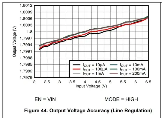

I attached, as an example, a line regulation plot from a TI TPS62840 buck converter module. Any insight would be greatly appreciated.
TI TPS62840 Line Regulation graph from datasheet

  • First thing I'd like to make sure of. Are you asking about why there is a $\pm 400:\text{ppm}$ variation on the output over various output loads when the input varies $\pm 2\times 10^6:\text{ppm}$? Maybe I'm just reading the chart wrong. – jonk Nov 20 '22 at 20:53
  • More or less, yes. I know it sounds silly given that the output voltage change is so small, but I want to understand why there is any change at all if the feedback is capable of adjusting itself in a continuous analog fashion – John Allen Nov 20 '22 at 21:09
    It's just that no matter how much gain you create, it's always finite! There will always be some kind of small variation like this. It's just not possible to create ideal circuits. One could consider integrating the error and pushing. But this would greatly retard the response and make it sluggish to the point of uselessness. Reality just isn't perfect. Engineering is about making the right trade-offs. – jonk Nov 20 '22 at 21:11

Any feedback system that performs "regulation" compares its output with a known fixed value and, attempts to minimize the errors. Thus the output becomes the same (or a fixed ratio) to the known fixed value (aka the demand) thus: -
Output equals demand
That's the simple theory but, to drive the output towards the demand requires an error and, what you are trying to do ideally is minimize the error. Do you see the problem?
You cannot have infinite gain and so, you accept that have sufficient gain to create a steady-state error in the output that is acceptable i.e. it doesn't precisely cause output to equal demand but, we "live with" the error.
If you look at your figure 4 (in the question) you could work how much the error amplification is. For an input range of 2.5 to 6.5 volts (4 volts delta), the output shifts from 1.7994 volts to 1.8006 volts (a delta of 1.2 mV). Thus, you can say that the error amplifier has a net gain of 4 volts ÷ 1.2 mV i.e. 3333.33.
There are more complexities to this but that's a broad estimation of the DC error gain.

    Andy, thanks a lot for your insightful answer and quick response! I guess one thing that still confuses me is how you are computing the error amplifier gain. The error amplifier is not seeing the input voltage of the converter as its input, it is seeing the output of the converter as its input. And its output is some voltage that drives the PWM signal on or off. I guess what you are computing is the system gain. I need to review some control theory and why going to infinite gain results in zero steady state error, but I think you have put me on the right track. – John Allen Nov 20 '22 at 21:45
  • @JohnAllen Think of what happens when you have no error control; if the input changes, the output changes proportionately (a not very respectable regulator of course). To be more accurate in my calculation I should have used the output error change when no error reduction feedback is present. So, mid-scale for 4.5 volts in you'd get 1.8 volts out and, with 2.5 volts in you'd get 1 volt out and, with 6 volts in you'd get 2.4 volts out. In other words, my calculation should strictly have been a delta on the output of 1.4 volts with no error feedback reducing to 1.2 mV with error feedback...... – Andy aka Nov 20 '22 at 21:53
