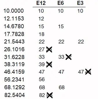

I'll start with the full diagram and then explain the details of each step along the way in a moment:
Series E3
Starting with E3, simple computation yields: \$\begin{align*}\textbf{E3}&\left\{\begin{array}{l}\lfloor 10^{1+\frac{0}{3}}+0.5\rfloor= 10\\\lfloor 10^{1+\frac{1}{3}}+0.5\rfloor= 22\\\lfloor 10^{1+\frac{2}{3}}+0.5\rfloor= 46\end{array}\right.\end{align*}\$
But there's an immediate problem related to coverage. They are all even and there's no way of composing odd numbers using only even numbers.
At least one of these numbers must change, but they cannot change 10 for obvious reasons.
To change just one, the only possibilities are: \$\begin{align*}\textbf{E3}_1&\left\{\begin{array}{l}10\\\textbf{23}\\46\end{array}\right.\end{align*}\$, or else, \$\begin{align*}\textbf{E3}_2&\left\{\begin{array}{l}10\\22\\\textbf{47}\end{array}\right.\end{align*}\$.
But \$\textbf{E3}_1\$ still has a problem related to coverage. The difference between 46 and 23 is itself just 23. And this combined value is a number already in the sequence. (This means that you can't reach a new integer by putting two 23 Ohm resistors in series -- the 46 Ohm resistor suffices. So the coverage is poorer.) In contrast, \$\textbf{E3}_2\$ doesn't have that problem, as the differences and sums provide useful values not already in the sequence.
Rationalized, it is: \$\begin{align*}\textbf{E3}&\left\{\begin{array}{l}10\\22\\\textbf{47}\end{array}\right.\end{align*}\$
Series E6
The next step is to examine E6. First and foremost, E6 must preserve the values that were determined for E3. That's a given that cannot be avoided. Accepting that requirement, the computed (and E3 retained) values for E6 are \$\begin{align*}\textbf{E6}&\left\{\begin{array}{l}10\\\lfloor 10^{1+\frac{1}{6}}+0.5\rfloor= 15\\22\\\lfloor 10^{1+\frac{3}{6}}+0.5\rfloor= 32\\\textbf{47}\\\lfloor 10^{1+\frac{5}{6}}+0.5\rfloor= 68\end{array}\right.\end{align*}\$
But a coverage problem shows up, again. The difference between 32 and 22 is 10 and this is one of the values already in the sequence. Also, 47 minus 32 is 15. So there are at least two problems to solve. And 32 is involved in both. Changing it to 33 solves both these problems at once and provides the needed coverage.
Rationalized, it is: \$\begin{align*}\textbf{E6}&\left\{\begin{array}{l}10\\15\\22\\\textbf{33}\\\textbf{47}\\68\end{array}\right.\end{align*}\$
Series E12
E12 must preserve the values that were determined for E6, of course. The computed (and E6 retained) values for E12 are: \$\begin{align*}\textbf{E12}&\left\{\begin{array}{l}10\\\lfloor 10^{1+\frac{1}{12}}+0.5\rfloor= 12\\15\\\lfloor 10^{1+\frac{3}{12}}+0.5\rfloor= 18\\22\\\lfloor 10^{1+\frac{5}{12}}+0.5\rfloor= 26\\\textbf{33}\\\lfloor 10^{1+\frac{7}{12}}+0.5\rfloor= 38\\\textbf{47}\\\lfloor 10^{1+\frac{9}{12}}+0.5\rfloor= 56\\68\\\lfloor 10^{1+\frac{11}{12}}+0.5\rfloor= 83\end{array}\right.\end{align*}\$
More coverage problems, of course. 83 minus 68 is 15 and 15 is already in the sequence. Adjusting that to 82 solves this issue. But 26 has a prior span of 4 and a following span of 7; and 38 has a prior span of 5 and a following span of 9. These spans should, roughly speaking, be monotonically increasing. This situation is quite serious and the only options really are to adjust 26 to the next nearest upward alternative of 27 and to adjust 38 to its nearest upward alternative of 39.
Rationalized, it is: \$\begin{align*}\textbf{E12}&\left\{\begin{array}{l}10\\12\\15\\18\\22\\\textbf{27}\\\textbf{33}\\\textbf{39}\\\textbf{47}\\56\\68\\\textbf{82}\end{array}\right.\end{align*}\$
