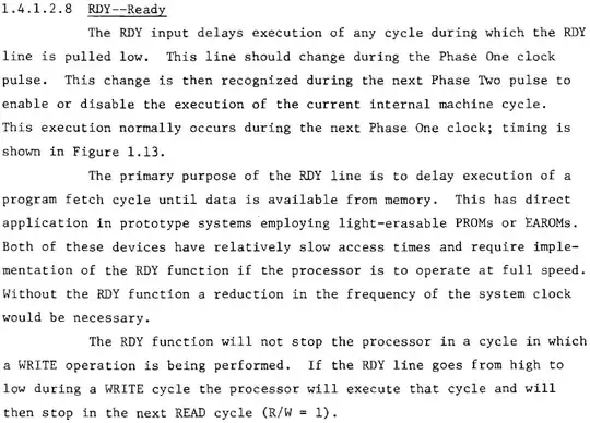

As with any device, its manual should be the first stop for any research. In this case maybe the 6502 datasheet, or if you really want to know, the
MCS 6502 Family Hardware Manual of 1976 for example at Archive.ORG
especially
Section 1.4.2.8 RDY -- Ready
on page 37:

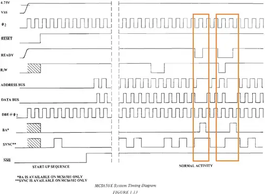

The mentioned diagram 1.13 shows the application of RDY for read and write (emphasis mine).

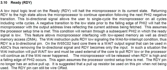

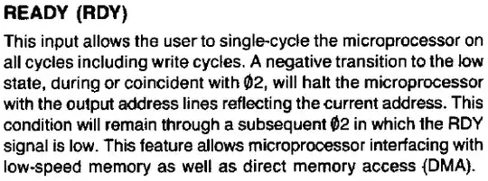

Similar description is found for the 65C02 in the datasheet of its original developer Rockwell:
As well as in the 2016 65C02S datasheet by WDC:
Bottom line: No matter what version, whenever you want the CPU to wait for one or more cycles, pull RDY until that need to wait is resolved. The CPU will repeat that cycle as long as it is pulled and continues with whatever is presented during the last.
