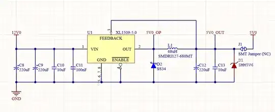

I've previously designed a board for a quite similar purpose to yours. I used an XL1509-5.0 buck converter to get down to 5V, then an AMS1117-3.3V LDO to drop from 5V to 3.3V.
The XL1509's datasheet provides a reference design and tells you all the parts you need. The bill of materials for my buck converter design was:
  • Input capacitors: 2x RVT1V221M0810 220uF Electrolytic (C3340), 1x CL31A106KBHNNNE 10uF 50V MLCC (C13585)
  • Output capacitors: 1x RVT1V221M0810 220uF Electrolytic (C3340), 1x CL21A106KAYNNNE 10uF 25V MLCC (C15850)
  • SS34 Schottky diode (C8678)
  • SMDRI127-680MT inductor (C9907)
The numbers in brackets are the LCSC part numbers.
Here's my schematic:
The parts with the red crosses are do-not-populate, so just ignore them. You also don't need D1.

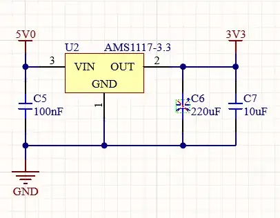

The output of the XL1509 goes straight into the input of the AMS1117-3.3V LDO, with a CL21A106KAYNNNE 10uF capacitor between the output and ground. The AMS1117 has very good ripple rejection and is very cheap.
The ESP32 was decoupled with 1uF and 100nF MLCCs very close to the VCC pins.
For reverse polarity protection, I'd recommend just using a Schottky diode. Your current demands are small so you don't need anything fancy like an ideal-diode MOSFET.
For overvoltage protection, add a 20V Zener diode clamp over the input. The XL1509 can take up to 40V, so the clamp will kick in way before.
You might also want to consider a TVS diode for ESD protection.

  • Alright I will try to figure this out, however since it is an IO module, I'm running 6 relays with a NUD3160, it has a max draw of 150mA, 150*6= 900mA, so combined with the 250mA of the ESP, and a tiny bit for the SN65HVD230DR transceiver, I'm well into the amp ranges, will this circuit be ok with that? (Sorry for not mentioning this) – Lolimpol Nov 13 '22 at 19:24
  • I can't edit, but I realised all the NUD3160's are supplied with 12v, and the ESP simply pulls the gate high, and the 150mA comes straight through the huge VSS traces. – Lolimpol Nov 13 '22 at 20:04
  • Yeah, the regulator doesn't need to supply the relays so you'd be fine here. The XL1509 can deliver up to 2A with the BoM I showed, and the AMS1113-3.3V should be good up to about 700mA. – Polynomial Nov 13 '22 at 20:12
  • I've added a schematic for reference. – Polynomial Nov 13 '22 at 20:14

  • What is the advantage of putting multiple caps in parallel? Why not one 400uF, or as Lundin suggests, higher? – Lolimpol Nov 15 '22 at 17:23
  • @Lolimpol JLCPCB charges a fixed fee per extended part you put in a design, so using three of the same capacitor parts instead of two different ones ends up being cheaper. Putting the two 220uF capacitors in parallel also halves the ESR. – Polynomial Nov 15 '22 at 17:34
  • @Lundin Just wanted to be sure; in some contexts it can also mean an overvoltage scenario, and I know there can be some pretty nasty transients on automotive rails. – Polynomial Nov 15 '22 at 17:55
  • I'm copying your schematics, what kind of TVS would you recommend/what should I look out for? And what value caps should I pick, because the 220uF is low like @Lundin suggests? – Lolimpol Nov 16 '22 at 17:52
  • Output cap on the buck reg should be 220uF still (read the datasheet for part values), you can bump the input caps up to a pair of 470uF to give you some headroom. For TVS, standoff/operating voltage of about 18V should be fine since the buck reg can handle up to 40V on its input. – Polynomial Nov 16 '22 at 18:07

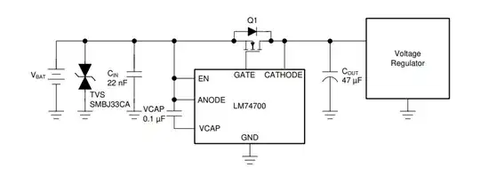

Here is a protection circuit that uses an ideal diode chip.
If you don't need to the 'ideal diode' low drop efficiency then you can replace the chip and MOSFET with a series diode. The voltage regulator should be able to withstand transients of +45V or more (I would suggest 60V as conservative) since the TVS cannot clamp perfectly (and it's not acceptable to reduce the breakdown voltage because it would no longer meet the specifications). You can pick a switching regulator chip that meets your output current requirements and can withstand worst-case input voltage. You can also go beefier on the TVS without changing the voltage- the part just gets bigger and a bit more expensive.
The actual automotive transient specs are not freely available (legally) but manufacturers of TVS diodes often reproduce the important bits in their application notes.

  • This looks good, I'm not so concerned with cost. The whole car project is in the 20k range, so a few extra euro's for a more robust system is allowed in my book. What are the advantages of replacing the MOSFET with a diode? I dont quite understand the low drop effiecency – Lolimpol Nov 13 '22 at 19:29
  • @Lolimpol The only advantage would be price. The LM74700 is some 'deluxe' version ensuring that the MOSFET doesn't take a blow, it's a more rugged version of this common solution: https://electronics.stackexchange.com/questions/552381/need-help-in-understanding-the-mosfet-reverse-polarity-protection-circuit. As for why a MOSFET substrate diode is used instead of a plain diode: much lower voltage drop. – Lundin Nov 14 '22 at 15:11
  • As for the TVS then I believe 33V is a common choice for 24V systems and in case of 12V systems we should pick something lower, around 18V. Also this one is way too weak (600W peak pulse power), I've failed industrial/automotive EMC tests when we used similar. Go with >1600W rated. – Lundin Nov 14 '22 at 15:14
  • @Lundin The higher voltage spec for 12V systems comes from avoiding failure with a double-battery startup. Maybe that can be ignored for an EV. – Spehro Pefhany Nov 14 '22 at 15:40
  • Aah, hehe... I guess that is a valid use-case. Well, still don't pick a 600W one. The more rugged the TVS, the better. There's another rare(?) use-case scenario: clumsy mechanic shorted battery + against chassis. A rugged TVS could take that blow for a short period of time. – Lundin Nov 14 '22 at 15:55
