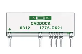

You can use a voltage divider to reduce the voltage down to a level safe for the ADC. The same math applies when calculating the current through the divider and the ratio. The difference is in physical construction.
A critical thing to watch out for is the voltage rating of the resistors. A small package resistor will not be able to stand off the voltage and break down. Depending on the industry this is handled either by using HV resistors made for this purpose (see picture), or by putting multiple resistors in series to spread the voltage drop.
I would also recommend putting a buffer on the output of your voltage divider. This will allow you to place the arduino farther away from the divider without introducing signal issues. Additionally you need to ensure you clean up solder flux residue and other contaminants. Keep sufficient creepage and clearance distances to other circuits.
If there is any substantial power behind your 600V source (like a battery pack) I would also recommend placing an appropriately rated fuse in line. 600V is not to be taken lightly. Be careful, and test your design with a current limited source. If you're not feeling confident just go buy a sensor.
EDIT: The divider datasheet: http://www.caddock.com/Online_catalog/Mrktg_Lit/Type1776.pdf Image from here
