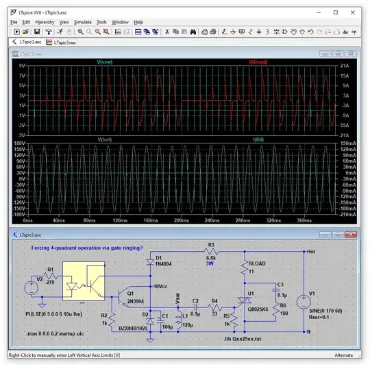

I got the possibly hare-brained idea to cause a single TRIAC gate pulse to go positive and negative, and thus fire in (maybe not all four but) more quadrants:
Forcing Multiple-quadrant TRIAC operation?
ThecLTspice simulation seems to show this Q8025K6 TRIAC (model here) working as expected in multiple quadrants.
The intent is to control the speed of a universal AC motor, 1.75 HP on 120 VAC, as a "spindle" motor "controller" of sorts. I am only considering the AC phase control here.
Blue is the gate voltage/current, red is the output current, and grey is the mains voltage. The output phase goes from 0% to 100% twice in the time shown, due to the opto pulse source having a period of 8 ms on a mains period of 16.667 ms.
However, SPICE models are never all-encompassing; do you think this would even work in reality? Am I overlooking anything that would be problematic?

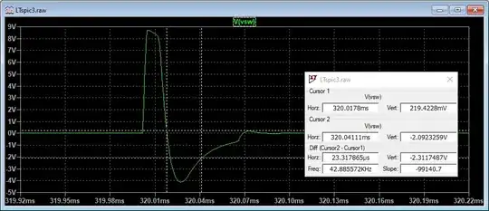

Gate pulses are about 15 µs wide positive (150 mA peak drive) and 20 µs when negative (100 mA peak drive, from LC components.)
Gate pulse with Negative Traversal

  • Neat idea, but.... why? And if you just want to know whether multi-quadrant firing works, the answer is too short to accept ("yes") :) – Tim Williams Nov 08 '22 at 17:11
  • Why, because the original (typical) circuit will not fire on the negative-going mains without a negative gate pulse, or vice-versa. Remove L1/C2 and it's a fancy half-wave phase-controlled rectifier. – rdtsc Nov 08 '22 at 17:30
  • What typical circuit? If you mean like an MOCxxx driver, it's simply negative gate with negative mains because...that's how it's wired. Positive gate and negative mains works too, it's just less often you have a common ground with a control circuit (implied: DC supply) and a TRIAC where that would apply. Or if you needed half wave operation, just use an SCR? Or are you saying the SPICE model isn't meeting datasheet quadrant behavior? – Tim Williams Nov 08 '22 at 17:47
Yep, totally hair-brained.

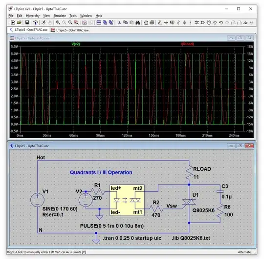

This is simpler, and works in quadrants I and III specifically:
Opto-TRIAC in Quadrants I / III
Seems in the original question I was trying to force operation in quadrants II / IV because the pulse reference was MT1; swapping the reference to MT2 makes the device much easier to fire, and doesn't require any negative input pulses at all.
