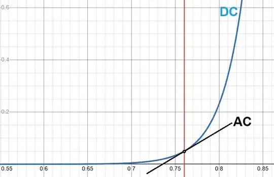

Let's look at what I mean. Here's an example chart:
To find the DC operating point, you need to use the full Ebers-Moll model. There are ways to simplify that process to get close. But exact solutions require some advanced mathematics or else a simulator. It's not necessary to use exact solutions, though, since BJTs vary so much one-to-another. So approximations usually work well.
Once the DC operating point is found (approximately or exactly), you can now take the slope at that point and greatly simplify the math involved in understanding how the BJT will behave when faced with small signals nearby this point.
To summarize:
  • The blue curve is similar to the large-scale, highly non-linear behavior of a BJT and it is used to find the DC operating point.
  • Once the DC operating point is uncovered by some means, then a nice tangent line (shown in black) can be drawn at this point to describe the AC behavior for small signals near the DC operating point.
