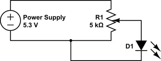

I have a random LED that I don't have datasheet/ spec. information for. I used a potentiometer connected to 5.3V as a voltage divider, which connects to the LED like so:
schematic
I gradually turn the potentiometer knob, slowly increasing voltage from 0V till I got a nice comfortable shine at 2.0V across the LED.

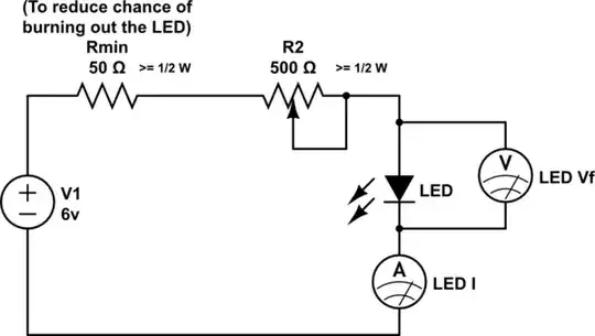

If you wanted to determind the LED parameters manually without a datasheet this might be a more suitable arrangement:
schematic

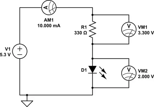

Your circuit with a resistor looks like this, with some extra measurements in place to explain what's happening:
schematic
Your mistake is to assume that 5.3V exists across the resistor R1, which is definitely not the case, as can be seen on voltmeter VM1.
You should study Kirchhoff's Voltage Law (KVL), which I'll paraphrase here as saying that the sum of voltages across R1 and D1 must be the the same as the voltage across source V1.
This you can also see in the schematic above. The voltage across the two voltmeters VM1 and VM2 is \$2.0 + 3.3 = 5.3\$.
The answer to your first question, is yes, you are correct to say that the "forward voltage" of D1 is indeed 2.0V (at least for your particular diode it is).
To your second question, my answer is that the voltage across R1, which will ultimately determine the current around the loop, is not 5.3V, it is 3.3V, as predicted by KVL.
Therefore, before applying Ohm's law to determine the required value for R1, first you must apply KVL to determine the correct voltage across R1:
$$ \begin{aligned} V_{R1} &= V_1 - V_{D1} \\ \\ &= 5.3 - 2.0 \\ \\ &= 3.3\text{ V} \end{aligned} $$
Then you may apply Ohm's law to R1. Assuming your desired current through R1 is 10mA:
$$ \begin{aligned} R_1 &= \frac{V_1}{I} \\ \\ &= \frac{3.3}{0.01} \\ \\ &= 330 \text{ }\Omega \end{aligned} $$
