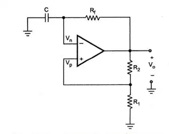

This is the circuit I'm considering.
I understand how Vo becomes Vsat, and Vn increases until it is equal to Vp, which is R1/(R1+R2)·Vsat.
Many people say when Vn slightly exceeds Vp, Vo is inverted.
However, my question is: how can Vn exceed Vp?
Right after Vn becomes equal to Vp, the output Vo will become zero (by comparator). Then C will discharge, then Vn < Vp, Vo becomes +Vsat again, and Vn increases again until it becomes equal to Vp and Vo will be zero again, therefore Vo will be oscillating between zero and Vsat.
Is this wrong?

  • You are asking about positive feedback action in this circuit? https://electronics.stackexchange.com/questions/465430/waveform-at-the-negative-terminal-of-an-opamp/465585#465585 – G36 Oct 30 '22 at 09:16
  • I'm mainly asking why the output doesn't become zero when Vref=Vin. – user18926955 Oct 30 '22 at 11:27
  • Due to positive feedback provided by R2, R1 voltage divider – G36 Oct 30 '22 at 11:46
  • Then Vout is nonzero even if Vp=Vn? Due to what principle? – user18926955 Oct 30 '22 at 15:05
    Do you understand that there are 2 trip points ? – Antonio51 Oct 30 '22 at 15:13
  • If you use bipolar supply. – Antonio51 Oct 30 '22 at 15:22
  • We have an opamp output at +Vsat and the capacitor voltage is rising (Vn < VP). And when Vn = Vp the opamp output voltage starts to decrease towards -Vsat. But, notice that the capacitor voltage continues to rise (because of Vn < +Vsat). Also, as output voltage "moves" towards -Vsat the Vp will start to decrease along with Vout. Thus, we no longer have Vn = Vp but we have Vn < Vp instead. And this process cannot be stopped because Vp follows Vout the changes due to positive feedback provided by R2, R1 voltage divider. Do you see it now? – G36 Oct 30 '22 at 16:30

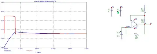

All this can be view when making the simulations.
Ever check your "thinking" ...
As pointed out by @Spehro Pefhany ...
When bipolar supplies ... with 2 trip points.
With unipolar supply ... Where is the other?

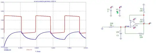

With an added resistor to the ground ... Note that the R6 value is very "special" ... to work.

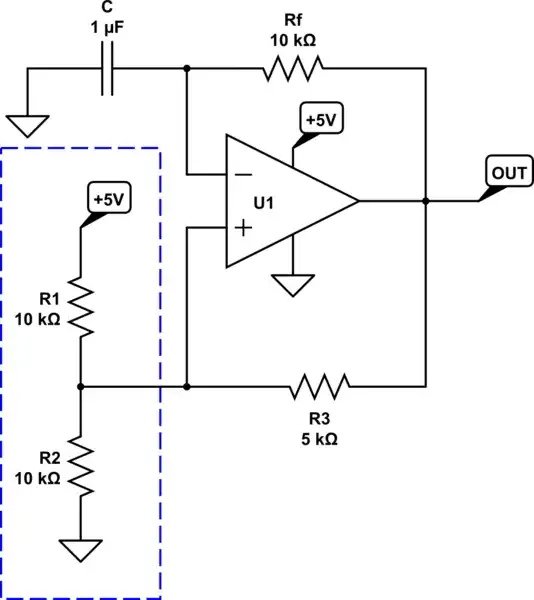

It's possible to modify this circuit to operate from a single-ended supply, by biasing the op-amp's feedback potentials. The idea is to raise the two switching threshold potentials so that they sit above and below half of the supply voltage. The lower threshold is then well above zero, allowing the the junction of C and Rf to swing below it, something that it can't do in the existing setup.
schematic

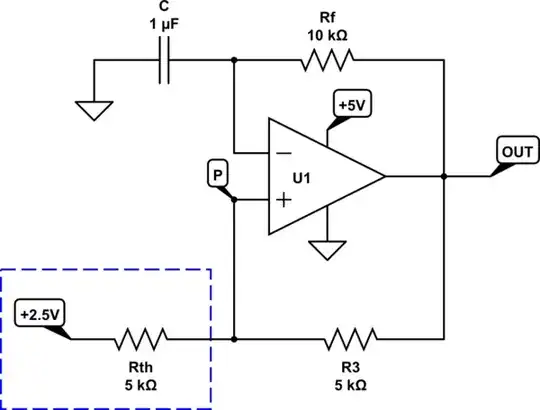

Here R1 and R2 have changed role. They now provide a potential half way between the supplies, at +2.5V. R3 allows the op-amp output to modulate that value somewhat. The simplest way to understand this is by replacing the combination of the +5V source, R1 and R2 (boxed in blue) with their Thévenin equivalent:
schematic
simulate this circuit
Now it becomes clear that as the output switches between +5V and 0V, the potential divider formed by Rth and R3 applies feedback with some fraction of the amplitude of that oscillation (one half in this example, since Rth = R3), centered about +2.5V.
With the values shown, and assuming the op-amp output is rail-to-rail, the two threshold values will be \$V_P = +2.5 \pm \frac{2.5}{2}\$, or \$V_P = 3.75, 1.25\$
