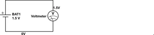

The usual case looks like this:
schematic
If you do something like this, you will get a negative voltage, but then you aren't measuring the battery voltage anymore:
schematic
simulate this circuit
In this second case, you are measuring the voltage from the junction of the two resistors to the minus pole of the battery.
