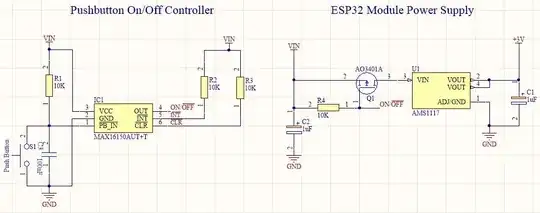

I am trying to design a circuit to turn on/off the ESP32. When I press the button, the ESP32 will start and will not turn off until I press the button again.
Will this circuit work for this problem?
