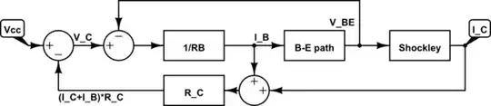

Inspired by the block diagram as shown by jonk in his contribution, I have created an alternative block representation of the feedback effect.
(Quote jonk: "However, an entirely different (but equivalent) diagram could have made the choice to go the other way.")
Interestingly, the diagramm does not explicitely show the parameter B (resp. beta) - however, this quantity is "hidden" in the series connection of the two blocks "B-E path" and "Shockley".
Explantion: The block "B-E path" contains the function V_BE=f(I_B) which is identical to the inverse Shockley equation: V_BE=VT*ln[1+(I_B/I_Bo)]
schematic
EDIT 2:
It should be noted that both block diagrams (jonk`s post and my post) are valid for DC signals only. That means: They show how the DC collector current Ic is developed as a result of the supply voltage Vcc.
However, both diagrams can be linearized (and evaluated) for small signals values only. In this case, they show how the collector current changes (delta Ic=ic) as a function of a supply voltage variation (delta Vcc=vcc).
For the above diagram the result is
ic/vcc=1/[(1/gm)+(RB/beta)+(Rc/beta)+Rc]
In order to show the stabilization effect this expression is compared with the case when RB is connected to Vcc:
ic/vcc=1/[(1/gm)+(RB/beta)] .

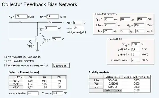

As polarization is sometimes complicated, this tool may help you.
AppCAD from Avago Technologies.
It calculates the "stability" of this configuration.

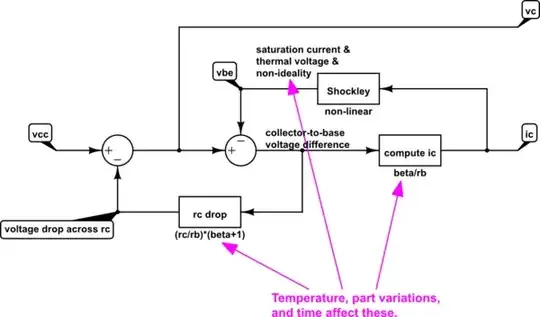

There exists more than one way to draw the feedbacks. But this one comes easier to mind (for me):
schematic
The above illustrates certain important details. For example, the Shockley equation that, when the NPN BJT is in active mode, expresses the relationship between collector current and base-emitter voltage. Either can be used to control the other. Here, I chose to show the collector current as creating a base-emitter voltage. However, an entirely different (but equivalent) diagram could have made the choice to go the other way.
All of the Ebers-Moll DC Level 1 model-related part, temperature and time variations are identified and shown where they exist in the feedback loops.

But you can readily see, as the single example I'll walk through now, that if there is a temperature effect that increases the saturation current of the BJT, which then acts to reduce the \$V_{_\text{BE}}\$ calculated from \$I_{_\text{C}}\$ by the Shockley equation, that this will have the effect of increasing \$V_{_\text{CB}}\$, which will then increase \$I_{_\text{C}}\$, which will increase \$V_{_\text{BE}}\$ and therefore counter the original effect due to temperature.
Feel free to consider all of the other ways that the above feedback diagram works to handle any number of various changes due to temperature, part variations, and drift over time (or even \$V_{_\text{CC}}\$.)

  • I think, however, this "counter effect" - caused by the small slope of the Ic=f(Vce) curve - is rather small and will not reduce the stabilization effect considerably. – LvW Oct 13 '22 at 07:14
  • @LvW The OP was more interested in seeing a block diagram with NFB. So that was my focus. Not quantifying specific details. Apparently, I was right about my guess? Agreed that the logarithm of Ic translates to a small effect on Vbe, though. A 1% change in Ic is about 260 uV change in Vbe, memory serving. – jonk Oct 13 '22 at 07:46
  • Let me say that the block diagram you have created is rather novel, I think. Up to now - I have never seen something similar. There is a simple block diagram for Re-feedback - however without the small "counter effect" you have mentioned. I think this effect does exist also for Re-feedback. – LvW Oct 13 '22 at 07:51
  • @LvW The OP had elsewhere asked me for an accurate NFB diagram (different question I'd answered elsewhere.) Didn't want KCL/KVL. Didn't want broad explanations that avoided an NFB diagram. It gradually became clearer to me what he was looking for. I haven't seen anything like this, either. However, it generates all the same equations that you'd get with KCL/KVL (avoiding the non-linear block.) The result for Vc shows the point you made about a divider between base and Vcc. The block diagram works. I made it up from the schematic with the idea to use the usual NFB blocks and summing junctions. – jonk Oct 13 '22 at 10:17
    Inspired by your block diagram I tried an alternative representation with Ic=f(Vbe). At the moment I can't upload it ("server error"). I will try later. – LvW Oct 13 '22 at 16:12
  • @LvW I knew it could be done (symmetry tells me such) and I was tempted. But it really makes me feel nice to hear that you attempted the alternative approach. I'd very much like to see it! – jonk Oct 13 '22 at 18:41
  • In my contribution (Edit) I have added "my blockdiagram". What do you think about it? (I will try to show a better diagram - not handwritten - soon) – LvW Oct 14 '22 at 07:45
  • It can be shown that for small signals (linearization of block diagrams) BOTH diagrams give the same result for the function delta (Ic)=f((delta Vcc) rsp. ic=f(vcc). I think this prooves the identity of both diagrams, – LvW Oct 14 '22 at 11:34
  • @LvW Thanks for that! I'll spend a little more time on it, shortly. But that looks about like what I would have hoped. Great! – jonk Oct 14 '22 at 16:38
