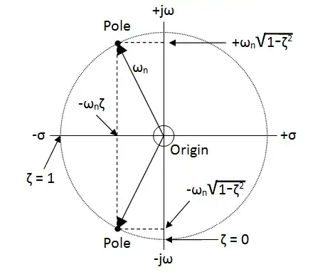

$$s = -\zeta\omega_n \pm j\omega_n\cdot\sqrt{1-\zeta^2}$$
Did you notice that I multiplied the terms inside the square root by -1 and brought-out the square root of -1 in the form of "j" the complex operator?

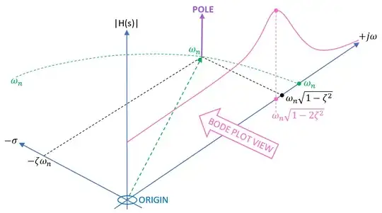

And this result is clearly a low-pass filter with conjugate poles: -
Image taken from my basic website. 3-D view of positive frequency pole: -
