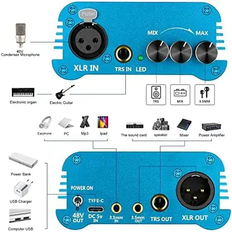

This direct box from Amazon allows me to take TRS audio output from the computer and convert it into XLR and I can take a XLR to TRS cable so I can connect it to the condenser microphone input on my V8 sound card.
Direct box/audio amplifier direct box/audio amplifier
XLR to 1/8 TRS XLR to 1/8 TRS
V8 sound card inputs V8 sound card

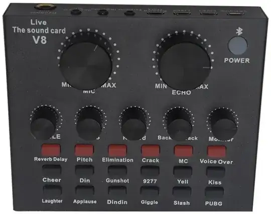

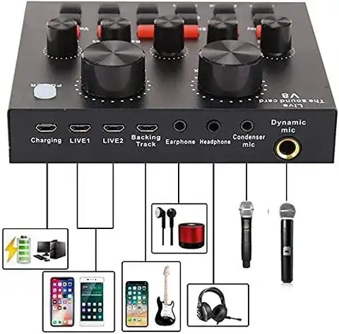

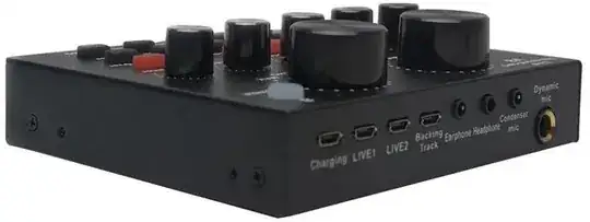

Is this the V8 audio interface you're using?
V8 audio interface, front
V8 audio interface, back

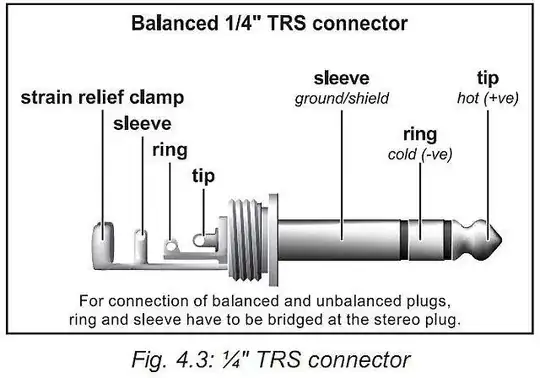

On your V8 interface, it will likely be balanced audio where:
  • tip is "hot"
  • ring is "cold"
  • sleeve is ground
  • (Phantom power applied between hot and cold)
TRS balanced audio pinout
Image source
With this information you may be able to create an interconnect cable. I can recommend Rane's Sound System Interconnection article for various wiring diagrams and best practices.
