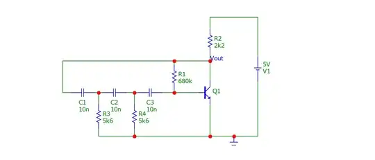

My assignment is to make an oscillator using only the elements given above.
This is the desired output waveform.
This is the circuit I have tried so far. Please tell me what is wrong and how can I make a circuit with such a waveform.
In your diagram you had base connected to +5 volts and that would have destroyed the BJT.

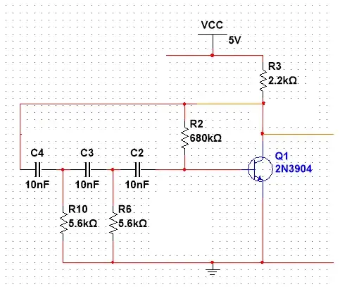

However, given the component choices you are presented with, this circuit seems to be the most likely one to work. It uses the 680 kΩ to self bias the BJT and will simultaneously present a low-ish impedance to C2 to create enough phase shift to cause oscillation: -

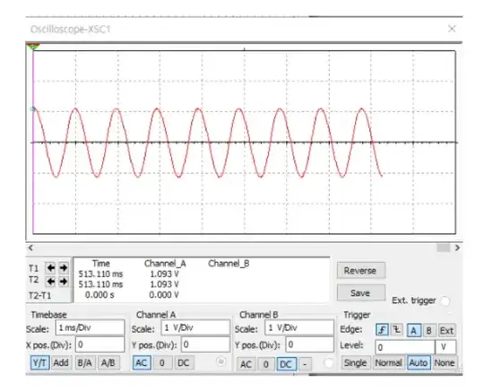

Yup, looks like it'll work: -
It oscillates at a shade under 1 kHz.
