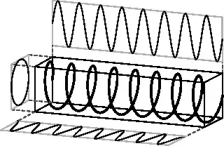

This is actually a deep dive into math. But basically, the sine or cosine frequency you know is not considered to be mathematically fundamental in the sense that they are not the simplest buildings blocks
What is considered the simplest building block is \$e^{jθ}\$.
Compare the three following cases:
$$e^{jθ} = cosθ+jsinθ$$
$$cos\theta = \frac{e^{jθ}+e^{-jθ}}{2}$$
$$sin\theta = \frac{e^{jθ}-e^{-jθ}}{2j}$$
\$e^{jθ}\$ actually describes something mathematically whereas \$cos\theta\$ and \$sin\theta\$ are just mysterious function names. And when you break cosine or sine up into a mathematical expression it is more complex than \$e^{jθ}\$
You can see from the three comparisons that it takes multiple \$e^{jθ}\$ terms to produce \$cos\theta\$ and \$sin\theta\$. It takes multiple terms because you need to get rid of the cosine or sine that you don't want from Euler's identity, and it requires negative values of \$\theta\$ to do this and that's where the negative frequencies come in. Because if your periodic functions are time dependent, \$\theta\$ is replaced with \$\omega t + \phi\$.
When graphed, \$e^{jθ}\$ looks like a coil in 3D space with the sine or cosine you know being a projection of that.
You should really just read the link that I learned this from which is here:
https://www.dsprelated.com/freebooks/mdft/Complex_Sinusoids.html
It's almost like a 5th dimensional object passing in and out of our 3-dimensional space plus time. Except it's not really passing in and out so much as it is being constrained to our 3D space, being projection.

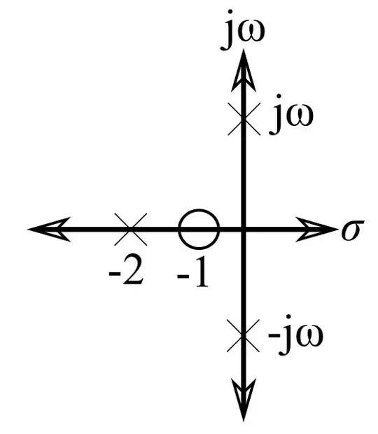

The crosses on the pole-zero map, shown below, represent poles in the Laplace domain. Circles represent zeros. The pole-zero map can represent either hardware, signals or both. The example shown is based on the transfer function that you provided.
The two crosses on the vertical (imaginary)axis represent a sinusoidal signal. They are both necessary for a single sinusoid. The pole-zero map does not represent phase.
All sinusoids appear on the vertical axis only. To the left are damped sinusoids and to the right are sinusoids increasing in amplitude. So in order to represent the sinusoidal impedances and transfer functions \$\sigma\$ must be \$0\$
For the transfer function: $$G(s)=\frac{s+1}{s+2}$$,
The pole on the \$\sigma\$ (horizontal) axis is \$p=-2+j0\$. The zero is at \$z=-1+j0\$.
All the poles and zeros on the diagram together represent the output signal.
Pole-zero map
I think the confusion, that arises, occurs when the Laplace variable is used to mean different things. When \$s\$ represents a pole it is customary to assign the letter \$p\$ to indicate it is a special value of \$s\$. The letter \$z\$ is the value of \$s\$ that represents a zero.
To transform a transfer function from the Laplace domain into the sinusoidal domain, only values along the \$j\omega\$ axis can be used. So \$\sigma\$ is set to \$0\$.
\$ s=j\omega\$ means \$s=0+j\omega\$. The values of the poles and zeros remain the same but the transfer function is restricted to the \$j\omega\$ axis.
