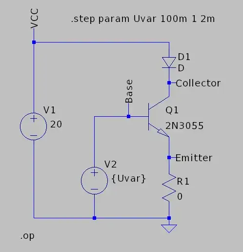

Experimenting with LTSpice for a LED current sink I apparently ran into the limits of the Ebers-Moll model / equation:
Schematic

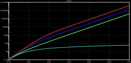

Simulation result
Instead of a straight line into ... lets say to 1000 A, there is a knee at around only 100 mA to 1 A.
I didn't expect to hit the limits of Ebers-Moll at such "low currents". Assuming the simulation results are correct.

Switching to a "more powerful" transistor doesn't show different results, nor does increasing R1 to 0.1 Ohms.

    That's not the entire Ebers-Moll equation. See here for the level 1 version (DC only.) There are three equivalent models. (Mathematically equivalent.) Shown there. You will also need to include the entire circuit in your analysis. This includes the diode. Finally, Spice programs use a rather more sophisticated model that includes operation in various current regions. See here. – jonk Sep 14 '22 at 07:58

One factor that I discuss here is the knee that occurs due to the increasing importance of minority carriers and their impact on majority carriers. The knee is modeled by the setting of IKF. I also mention there the significance of the collector resistance, which is modeled by the setting of RC.
However, the IKF factor (knee current due to current crowding) is only going to change the slope by a factor of 2, which on a log10 scale over a range of many magnitudes won't be very visible. So it's not the key factor.
However, the value of RC is \$85.6\:\text{m}\Omega\$ and the value of RB is \$810\:\text{m}\Omega\$. Both of which seem likely candidates for a problem at high currents. Also, while RE is less than \$1\:\text{m}\Omega\$, it's still a possible factor to worry over.
So let's just set all of them to near-zero and adjust IKF from the default value of \$1\:\text{A}\$ to 10X and 100X to see what happens:
Looks quite linear on the log-scale, now! The only difference is where the knee takes place on the three curves. The lower green one (the default case) bends over at \$1\:\text{A}\$. The middle blue one at \$10\:\text{A}\$. And the upper red one at \$100\:\text{A}\$. (This is the factor of 2 point of change.)
(The bottom-most curve is yours, for comparison.)
So you need to take into account bulk resistance for the pins. And you may also want to take into account the knee current.

    I cannot reproduce your results. At 1 Volt I don't get above 5 A. Here's my model: .model 2X3055FAKE NPN(Bf=73 Br=2.66 Rb=.0000001 Rc=.0000001 Re=.0000001 CJC=1000P PC=.75 MC=.33 Tr=.5703U Is=2.37E-8 CJE=415P PE=.75 ME=.5 TF=99.52N NE=1.26 IK=1000 Vceo=60 Icrating=10 mfg=STMicro) – ChristophK Sep 14 '22 at 14:44
    Oh, I made another mistake, had R1 set to 0.1 Ohm. Now it works :-) – ChristophK Sep 14 '22 at 15:15
