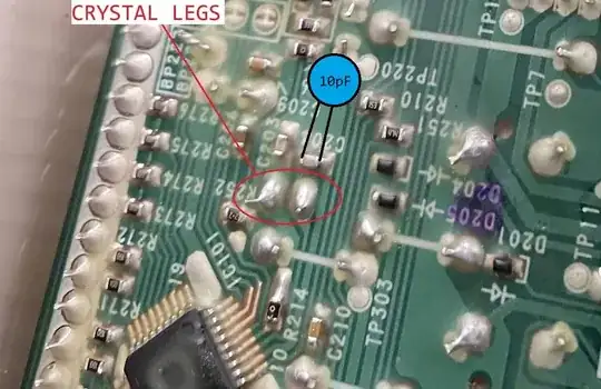

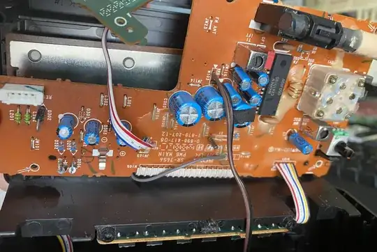

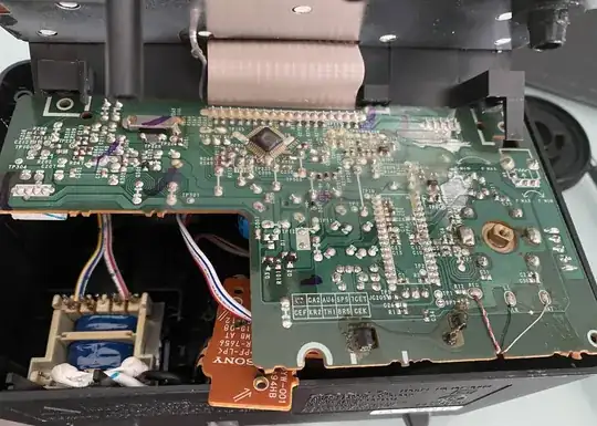

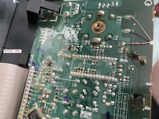

Here are the circuit board pictures:
Crystal legs circled
Bottom of board
Top of board

Problem: Clock gains ~1 second every ~24 hours
Attempt1: Attempt 1 was to simply change the crystal to a high quality 5ppm CITIZEN crystal (CFS-20632768HZFB). This did not yield a better result. Clock was still gaining ~1 second every ~24 hours.
Attempt2: Check continuity to make sure correct capacitor is used from one of the legs of the crystal to one of the sides of the capacitor C204. After confirming I attached 10pF capacitor (FG28C0G2A100DNT06) directly to C204. So far 48 hours later there appears to be no gain/loss. I will observe over the course of a few weeks to determine if there is a slow gain/loss and adjust accordingly by going either to 11pF (10pF + 1pF caps) or 9pF (6pF + 3pF caps).
Attempt 3: With 10pF capacitor the clock lost 1 second after 4 days. Means loss of 0.25seconds every 24 hours. This is 1.25 second swing per 24 hours (was too fast now slow) from before any capacitors were attached. If capacitance (pF) influence on the crystal is linear this means 1pF slows the clock down 0.125 seconds per day. Meaning that by lowering down to 8pF capacitor I should achieve 0.25 faster clock speed, which would bring it closer to 0. Replaced 10pF capacitor with 8pF (6pF + 2pF). Will report on results.
Attempt 4: With 8pF cap the clock lost 1 second per ~6 days. This means each 1pF does not influence the clock linearly. Removed the 2pF (from 6pF + 2pF) and will test it at 6pF. Will update with results. It seems like I am getting close. Even as it is 8pF improvement was ~1 minute off per year versus unmodified ~6 minutes off per year. Hoping to achieve ~1 sec per month/~12 per year or better, but 1pF increments may not allow for this. Will get as close as I can and report here.
Attempt 5: After much experimenting I found the balance, it is somewhere between 6pF and 7pF. To be more granular Id have to order sub 1pF capacitors. Currently with 7pF (6pF + 1pF) I achieved 1 second loss (slow) every 2 weeks or so. Which is sub 30 second drift per year. I am more than happy with the result. If I come across some sub 1pF caps Ill attempt something like 6.5pF (6pF + 0.5pF) to see if I can nail it even closer. Thanks all for your help!

  • Verify that you've found the crystal and its load caps.
  • It looks like the capacitors are surface-mount, so they won't be marked and you'll need some good soldering skills. Don't trash the board.
    • (that is a weird board layout, BTW -- "value design" rules, I guess).
  • If the clock is running fast, adjust one cap value up slightly -- I'm talking like 1pF at a time here, so be patient. If that doesn't overshoot, but doesn't get you where you want, adjust the other one up by 1pf. Repeat as necessary until things work.
  • If the clock is running slow, adjust one cap value down slightly, i.e., do the reverse of the step above.
Chances are that to start from a known point you'll have to replace the caps on the board anyway. I'd be strongly tempted to replace one or both caps with variable capacitors whose ranges center on 12pF, then tweak them. I'd also be strongly tempted to use 10pF fixed caps in parallel with variable caps whose range is centered on 2pF -- this will mean that you'll get less change in frequency for the amount you tweak the cap, which will, in turn, make your life easier.

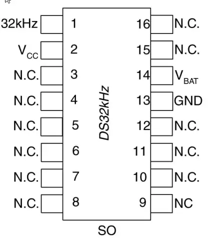

You can add a TCXO such as Maxim's DS32kHz to the board if you like.
  1. Glue the chip down, preferably on a ground pour (dead bug style- legs in the air).
  2. Remove R214 (0Ω resistor).
  3. There are four connections required to the chip. Attach (using AWG30 Kynar wire-wrap wire or magnet wire) GND and Vcc connected together (to pin 11 on IC101), Vbat (to pin 14 on IC101), and 32kHz (to pin 13 on IC101, where one side of R214 went). enter image description here
Or just muck with either one the caps (C203/C204). They're 22pF and you can get a trimcap and a few values of smt capacitor to get more values. I'd aim for 10pF +/-5pF more than the 22pF as just an educated guess based on estimated pullability of a random 32kHz tuning fork crystal and your 'running fast' number. So just connect the trimcap in parallel with one of the existing caps.

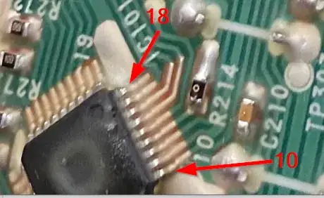

    how are you counting legs on IC101? I see the dimple, but which side is pin1? And which way does it increment? – Duxa Sep 11 '22 at 05:32

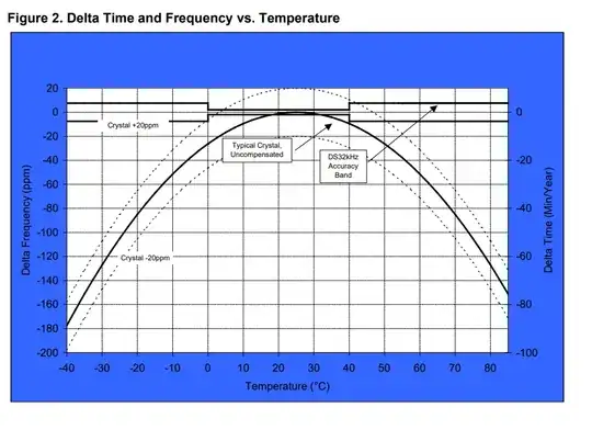

    @Duxa the typical drift in ppm of an uncorrected tuning fork 32kHz xtal is shown in the graph above (the convex parabolic curve). The xtal cut is optimized to minimize drift near room temperature/body temperature. – Spehro Pefhany Sep 11 '22 at 12:47
  • @SpehroPefhany, its a bit counterintuitive when you say connect VCC and GND pin together to pin 11. Are you saying to ground the VCC pin? If those 2 pins need to be tied together why are there 2 separate pins in the first place? Thanks – Duxa Sep 15 '22 at 17:44
  • Yes, ground the Vcc pin. The chip contains an internal battery/Vcc switch, and if there is an unused one it should be grounded. My reading of the datasheet is the Vbat is the one to choose for this application. Since the clock already contains a battery/Vcc switch only one is required. – Spehro Pefhany Sep 15 '22 at 17:49

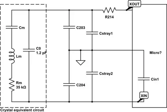

schematic
C203, C204, and R214 are from the image that you provided. Within the crystal equivalent diagram, the components with subscript "m" are the motional values. Co is the shunt capacitance between the pins.
The load capacitance \$C_{L}\$ required for the crystal to function is:$$C_{L}=C_{0}+\frac{C_{203}C_{204}}{C_{203}+C_{204}}$$
The datasheet for the linked 5 ppm capacitor has \$C_{L}=12.5\ pF\$ and \$C_{0}=1.2\ pF\$, so:$$\frac{C_{203}C_{204}}{C_{203}+C_{204}}=11.3\ pF$$. If they are equal then:$$C_{203}=C_{204}=22.6\ pF$$ The stray capacitance are probably 1 to 2 pF. Cin is harder to estimate, perhaps 2 to 5 pF. Perhaps others here can provide better estimates. \$C_{203}\$ and \$C_{204}\$ must be reduced to compensate.
The drive level for the 5 ppm device must be \$<1\ \mu W\$ for others \$<0.5\ \mu W\$. Typically they operate at 20% of the maximum. For series resonance, the power can be calculated using the motional resistance and the voltage drop across the crystal.
For the 5 ppm crystal the voltage drop should be less than 187 mVRMS. Probably closer to 50 mV. Because a scope's capacitance will load the crystal, I would increase R214 to the point where the oscillations stop. Then decrease until they start again. Then a further reduction of 10% to 20% will allow operation over temperature.
What are the chances that the new crystal will just work? Try it and see. But making sure the capacitance is right will put it at the right frequency.
To trim the frequency either one or both of \$C_{203}\$ and \$C_{204}\$can be adjusted to get the frequency.

  • Little update for the project. I got the crystals today. When I removed the stock crystal the clock errored out. So yes, definitely running off the crystal (behavior is flash 12:00 about 3 times, then broken segment display, with crystal in it continues to flash 12:00 until time is set). I put in the 5ppm CFS-20632768HZFB crystal, have been running for 1 hour, so far so good. Will take at least 24 hours to see if still 1 second off per day, Ill update how it does in a day or two. EDIT: I have not changed anything other than swap crystal, so caps are all stock. – Duxa Sep 15 '22 at 03:49
  • Another update, I added 10pF cap directly to C204. It has now been 48 hours, previously this would yield 2 second gain (1 sec per 24 hours). After 48 hours it appears to still be spot on (possible loss of fraction of a second, but hard to judge). I will monitor over course of a few weeks and make adjustments as needed. So far its a great improvement. If there is a loss of a fraction of a second each day Ill try going to 9pF (6pF+3pF). The other clock that I thought was perfect ended up gaining 1sec after 2 weeks. I added 1pF cap to that one and will monitor. Will update in a few weeks. – Duxa Sep 20 '22 at 20:21
