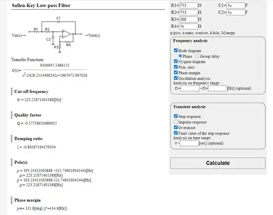

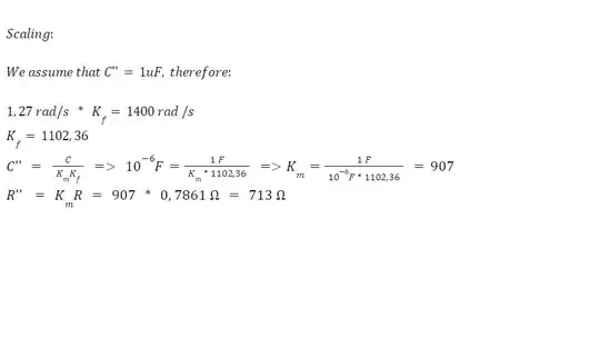

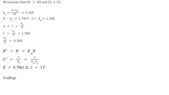

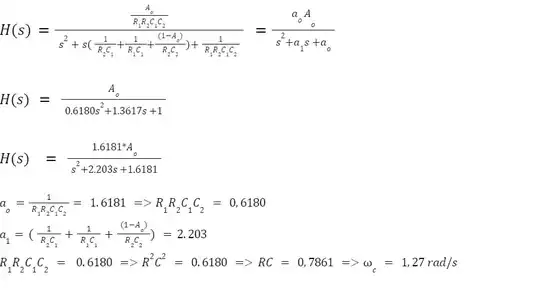

I'm trying to figure out the R and C elements for a second-order Bessel filter approximation. Unfortunately, in the below calculations the quality factor is negative, so it is wrong? (I checked by entering the values ​​into this design tool.)
Also, the poles have a positive real part.
In my calculations, I used the tips from this video.
I often come across the concept that the coefficients in the filter table are for the normalized form of the filter. What does that mean? I read somewhere that they were designated for RC = 1 (or it depends?). In the above example I assumed RC = 0,7861. Is that true?

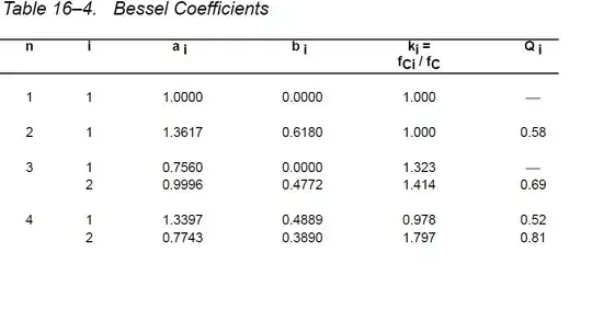

What does k = fci / fc mean in the table of coefficients? How to take into account the fci/fc parameter in calculations?
You have chosen to have a gain greater than three (\$1+\frac{R4}{R3}\$). Sallen Key circuits cannot have a gain equal to or greater than 3. I expect this is why the Okawa Denshi web site calculator got into a quandary. Try making R4 = R3 and see what happens. If you make R3 = 501 Ω (AV = 2.996) then you get a massive Q factor of 250.5 and, if you drop R3 to 500 Ω, Q becomes infinite.
The maximum gain (AV) of 3 comes from this relationship: \$A_V = 3 - \frac{1}{Q}\$
When you have a 3rd order or fourth order filter, there are two distinct filter cut-off frequencies; one for the first stage and one for the second stage.

Because you are using that table, which comes from "Opamps for everyone, Ron Mancini" (freely available, last I checked), I'll assume you are looking for a Bessel filter that satisfies a -3 dB @ 225 Hz (as per the poles displayed in your results from the Okawa-Denshi site).

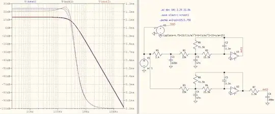

Finally, with that much talk out of the way, you can build the filter:
3rd order Bessel, -3 dB @ 225 Hz
I've chosen a multiple-feedback because the gain would have been impossible for Sallen-Key. There are two ways to do it with only one opamp: the unbuffered 1st stage is at the input (V(out1)), or at the output (V(out2)). Compare how they fare against the ideal transfer function (V(test)). Due to the loading effect, out1 is slightly distorted (look at the group delay, it has a slight peak), whereas out2 is better behaved but, only because it has no load. If, however, that load happens to be a high impedance input (such as another opamp) then you're scott-free because out2 and test are very similar. The gain might be slightly different.
