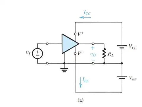

In this diagram the DC power sources for a linear amplifier are shown:
Circuit
We see there are two separate batteries connected to it, and then to ground on opposite ends.
Why must there be two separate power sources connected to a linear amplifier? Why not just connect it to a single power source with a specified voltage?

A single positive power source (referenced to 0 V) is fine if you only require positive-going output voltages, but if you require your output voltage to swing below ground (0 V) then you need a negative power rail.
You can't have negative-going output voltages without a negative power rail. Having two separate power sources allows the creation of the 0 V reference between them to which both input and output are referenced.

11
What they’re showing is an idealized dual-supply, or bipolar amplifier. Bipolar amplifiers have the ability to both accept and output signals that swing above and below the ground reference. This is made possible by the dual supply, which allows both positive and negative biasing. This is the classic style of op-amp powering, going back to the 1960s and parts like the uA709 and uA741, which are designed to run on +/-15V supplies.
(Note: confusingly, bipolar power is a separate concept from bipolar transistors.)
The alternative is the single-ended or single-supply amplifier. These will usually use GND as the negative amplifier supply. Thus, they limit their input and output swings to be between GND and the positive supply as there is only positive bias available. The LM324 is a well-known example of a single-supply op-amp, although it too can use a bipolar supply.
(Second Note: if you’re talking about real op-amps, review their data sheets carefully and observe their limits: their I/O voltage ranges will usually be less than the supply rails. On the other hand, also note that there are specialty op-amps that can accept wider input voltages, e.g., op-amps designed for high-side current sensing.)
Which kind of powering you would choose depends on kinds of signals you’re processing and your desire for low system cost:
  • If your signals are always above ground you would choose single-ended for lower cost. This is common for signal buffers to microcontrollers for example.
  • If your signals are bipolar AC (like audio), you can still use single-ended, with the addition of an artificial midpoint bias reference and AC coupling. Most portable audio electronics are built this way.
  • If your signals are very low frequency or DC (and thus can’t use AC coupling) and swing above and below ground, using bipolar supplies solves a lot of problems, at the expense of a separate negative supply. You often see this in instrument signal blocks, in high-end audio, and sometimes for high-power servo drives.
  • Finally, if your signals have a large swing, using bipolar allows for handling a greater voltage range. A uA741 powered with +/-15V can easily handle +/-10V signals.
That all said, textbooks tend to assume bipolar amplifier supplies because it simplifies input and feedback network analysis: they don’t have to consider the influence of an artificial midpoint bias.

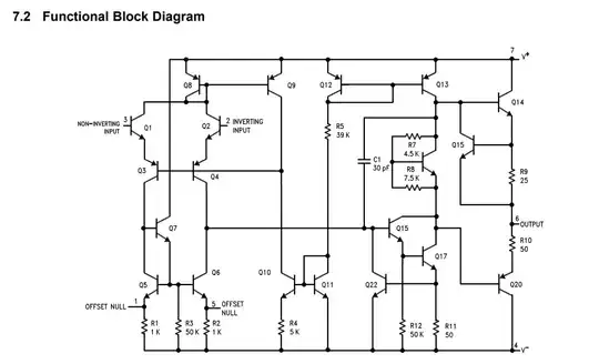

This is more related to the electronic construction of the input terminals from OPAMPS: a differential pair
If you carefully analyse the input stage from the venerable and rather horrendous LM741, you should be able to distinguish a differential pair connected to a current source below such input:
Symmetric supply voltage is needed to allow (as others have pointed out) full excursion of a signal entering the two terminals of the OPAMP. Basically, you want to establish a setpoint so that your signal is referenced right at a virtual zero allowing output swing between approximately Vcc and Vee (applicable only in true Rail-to-rail devices, and not quite, though). When both terminals are tied together, for instance, the output voltage should be zero as internally the OPAMP is computing the difference between the potentials at each terminal:
In Open loop:
$$V_o = A_v(V_+ - V_-)$$
where \$A_v\$ is the open-loop gain.
Since this is practically not possible offset null is added in some configurations to overcome input offset voltage
