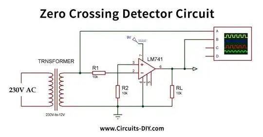

I'm building a cross detection circuit op-amp. I did something like this, coming from https://www.circuits-diy.com/zero-crossing-detector-circuit/ : enter image description here
In my case, primary is 230V AC, secondary is around 14V AC Op-amp is KA358A. It is powered by 3.3v.

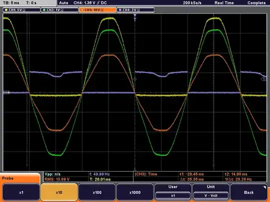

On the oscilloscope screenshot:
  • green is 230v primary input
  • orange is 14v secondary
  • yellow is op-amp IN-
  • blue is op amp output.
Scales are not always equal in order to see surimposed curves.

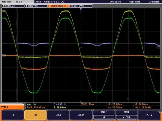

On this second screenshot:
  • orange is op-amp IN+
Resistor are 27k instead of 10k of the schematic but I don't think it is a relevant information.
I have 2 questions:
  • why is op-amp IN- clamped to -1V ?
  • why is op-amp IN+ clamped to -0.6V ?
  • why does op-amp output has this odd shape instead of a square shape ?
I suspect, it has something to do with the IC but I can't understand what.

  • You have no negative rail for the op-amp. You feed it a negative voltage on the input and it gets clamped to 0V. Looks like you want a comparator, not an op-amp. Look at the LM339 and use a capacitor is series with the input. – Kartman Sep 07 '22 at 14:21

Op-amps usually make for lousy comparators, and 741's or 358's output will look particularly atrocious even in a 60Hz zero-crossing detection application, since those op-amps can slew only very slowly. That would be if you powered it correctly, which you didn't (a negative supply is needed too). That's why the op-amp inputs were clamping: they have a diode from ground.

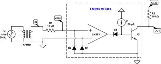

Instead, use LM393, LM339, or LM2901 comparator. The comparator's input common mode range extends to ground, and thus it's possible to use it with a single 3.3V supply as a zero-crossing detector.
schematic

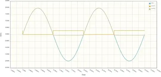

The output will be quite clean. The waveforms of the transformer secondary voltage IN, the (+) input pin +PIN voltage, as well as output voltage OUT are plotted below.
The transformer voltage, (+) input voltage, and output voltage waveforms
