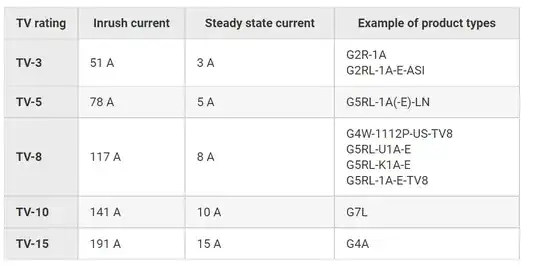

Look for relays with "TV" ratings such as TV5 or TV8. They are specifically rated for such inrush loads. For example this one. Life should be 25,000 operations with the rated inrush. Details are in (probably paid) UL publications, but here is Omron's intepretation of the ratings:
UL paid a great deal of attention to televisions ca. 1970 since they were at that time a significant cause of fatal house fires, and that is where the "TV" comes from.

  • UL publications are always paid, but the preview usually is good enough to read it;P I'll look into the TV-15 G4A, it seems interesting, thanks – Lorenzo Marcantonio Sep 06 '22 at 08:59
